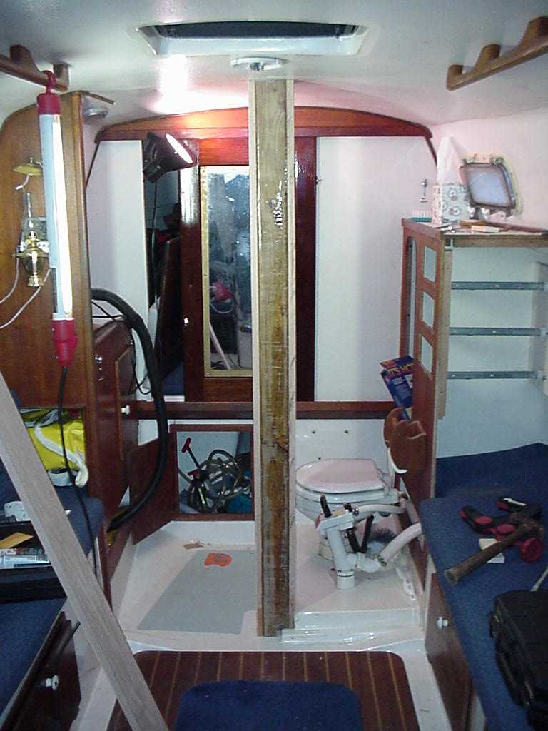

John, The compression post is just behind the main cabin bulkhead next to the head. It sits right under the mast and holds the cabin roof up from the loads the rigging puts on the deck. It is surrounded by a teak cover on three sides and the bulkhead on the forth side. Attached is a picture of mine when I replaced the bulkhead and post. The bulkhead has been removed in this picture. Hope this helps.

is there any way to inspect this w/out removing the teak dressing or bulkhead break? did you replace yours with a pressure treated 4x4? thanks for the great photo and info!

There is no way to physically inspect the post without taking off the teak covering. However the fit of the sliding door and the fit of the door header on the starboard side against the overhead will tell you a lot towards condition of post.I replaced mine with 2" Dia. 1/8" wall polished stainless steel tube. As far as cure for 8hp Yanmar-2GM20 Yanmar.

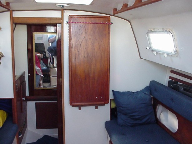

John, You can look at the back side of the post using a strong flashlight. Look between the sliding door and post. Check the bottom of the post for signs of rot. Also check the teak cover for crushing at the top and/or bottom and separation where the sides and front join. You cannot see much of the top of the post because the header is in the way. The door header is not a reliable sign of post problems. Hunter, when building the boat left 1/4" to 1/2" gaps between the bulkhead, header and the cabin roof and sides. They used fabric covered piping to fill and hide the gaps. As the piping deteriorates it pulls away from the sides and you see a growing gap along the bulkhead and header. That's what made me think I had a c-post problem and pulled my bulkhead and post. I did have the wood layers at the bottom of the bulkhead separating because of water damage and needed to replace it anyway, but my c-post was fine with no problems. I did use a pressure treated 4x4 for the replacement. The pic is the finished job. If you want more info e-mail me. BTW - I did all the work with the rigging up and the boat in the water.
