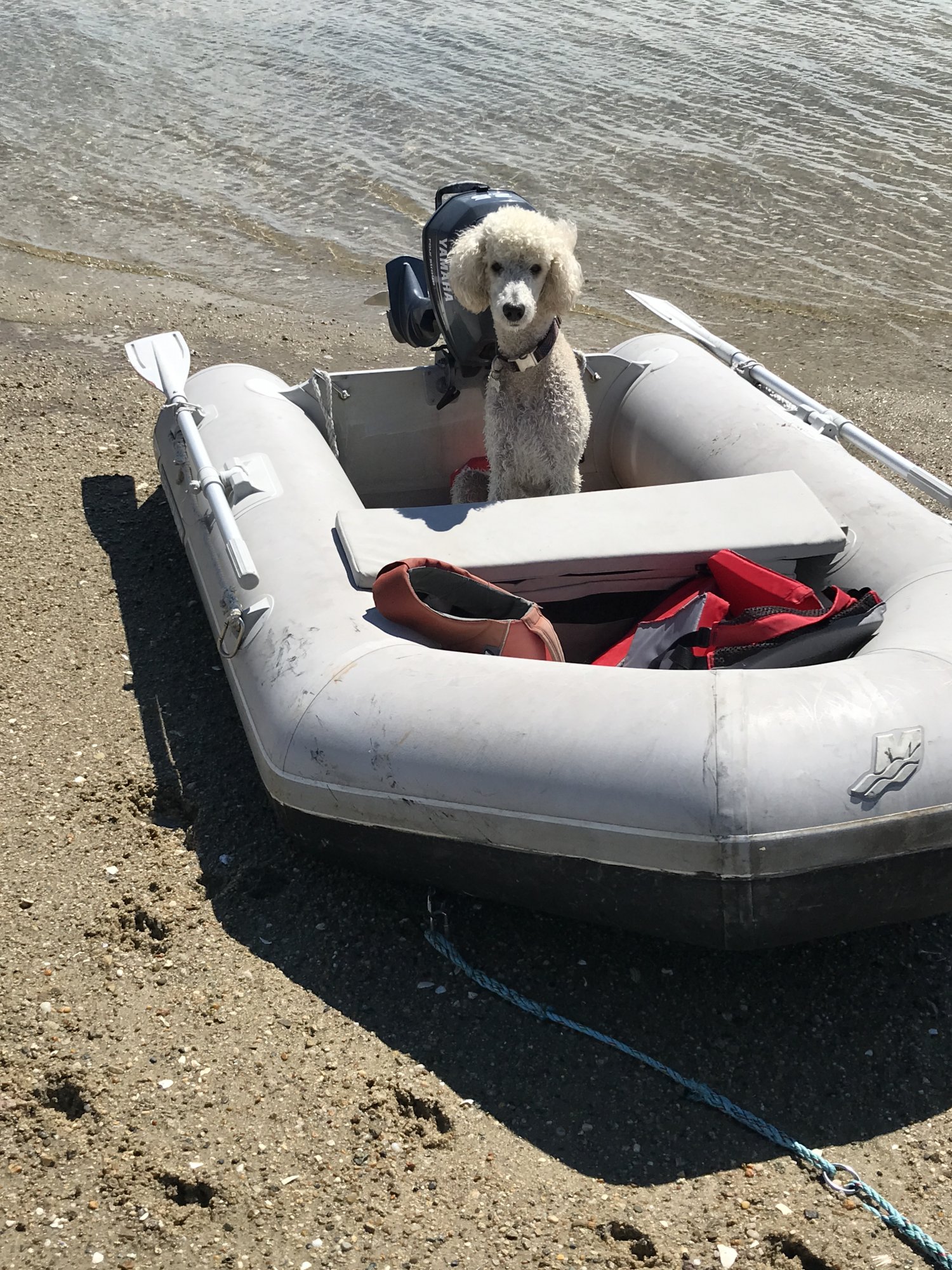

My PVC roll up is 14 years old. I am near Boston and my inflatable is always in the sun during the sailing season. I do not have any kind of of a cover. The PVC fabric has held up fine. We often leave the dinghy on the beach of various islands or floating near the water edge of the beach. Have one repaired bottom puncture that never leaked again. I paint the bottom to stop hard growth. Bottom line; PVC works for me.

Are your seems welded or glued?
