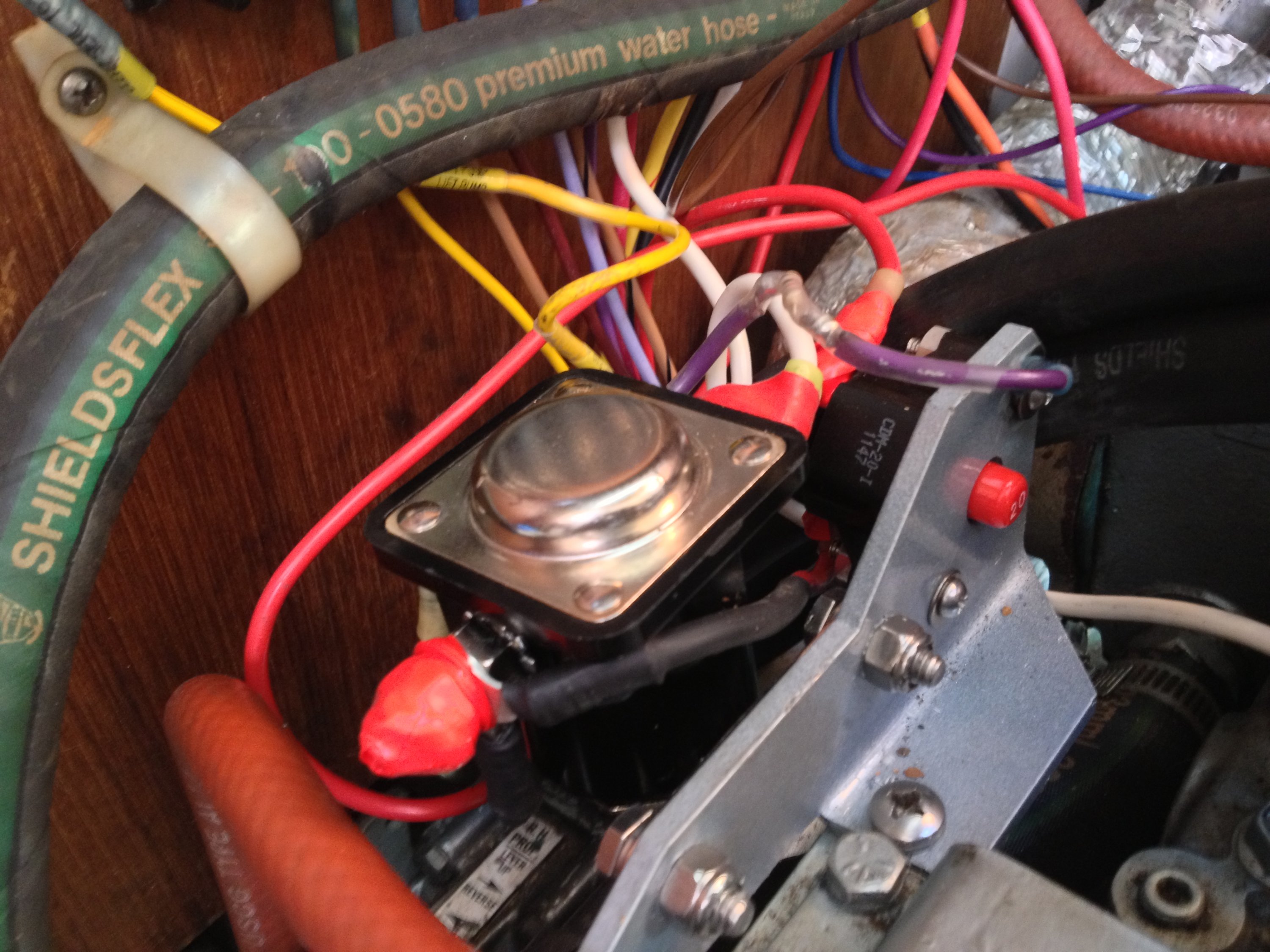

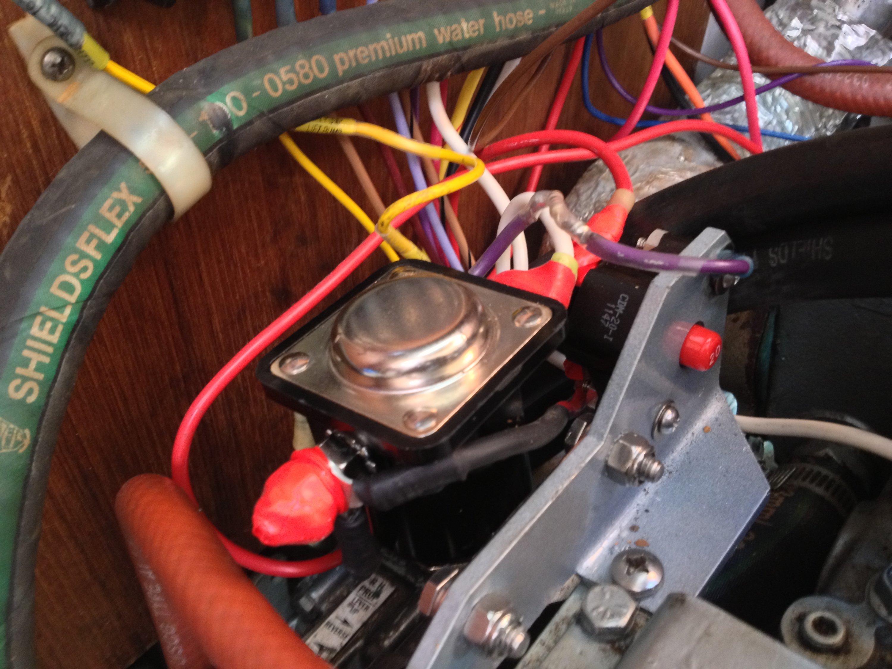

May 20, 2016
3,015
A picture of the area would be helpful for those of us not familiar with your engine compartment. Mine is zip tied to the aft side of the engine by the P.O. not pretty but functional.

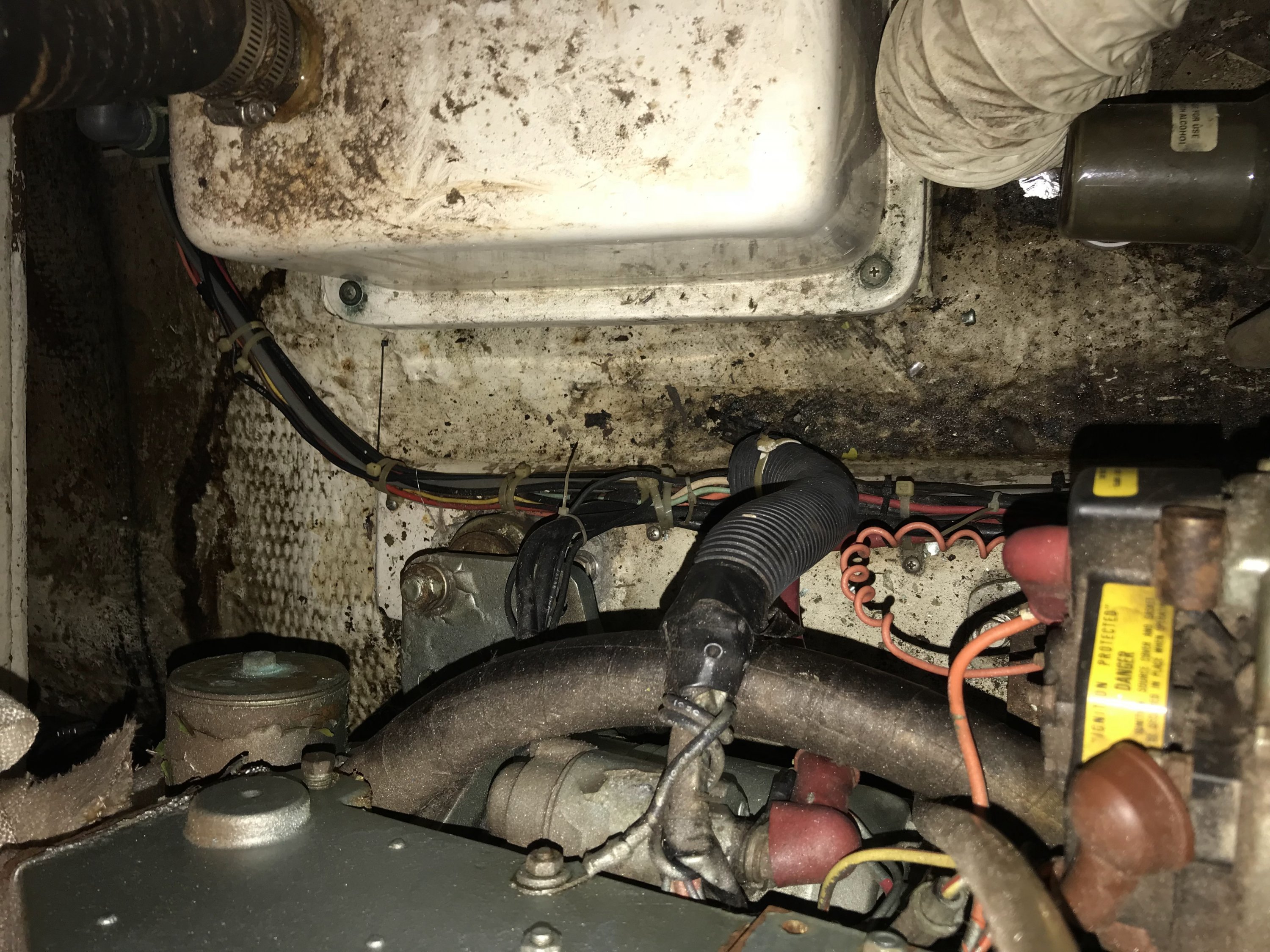

Here is a pic showing the aft side of the C30 muffler sitting on a base. There is probably better places to mount the solenoid as Stan mentions. If they screw the muffler down to it it would probably be OK to put a few more screws into it.
I'll go over it again.

there is a bracket available for mounting the solenoid and circuit breaker on the top of the engine. Universal part number for the M3-20 is
Universal, Bracket, Solenoid, Breaker, 200257
if you google that several sources come up - it costs about $25
As I mentioned earlier, or on Ward's other post about this, why would one want to install anything, that's anything, on a rockin' sockin' engine that didn't need to be there? $25 will buy you tons of nuts & bolts to mount it elsewhere and simply run a wire to the engines glow plugs.
