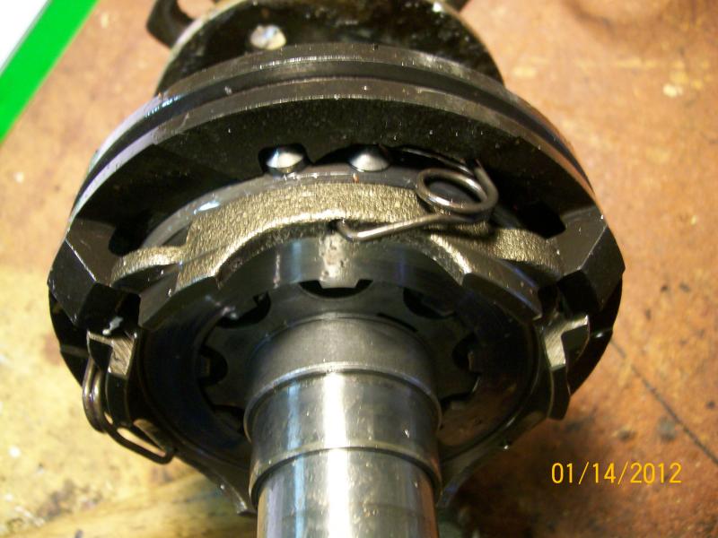

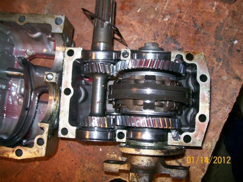

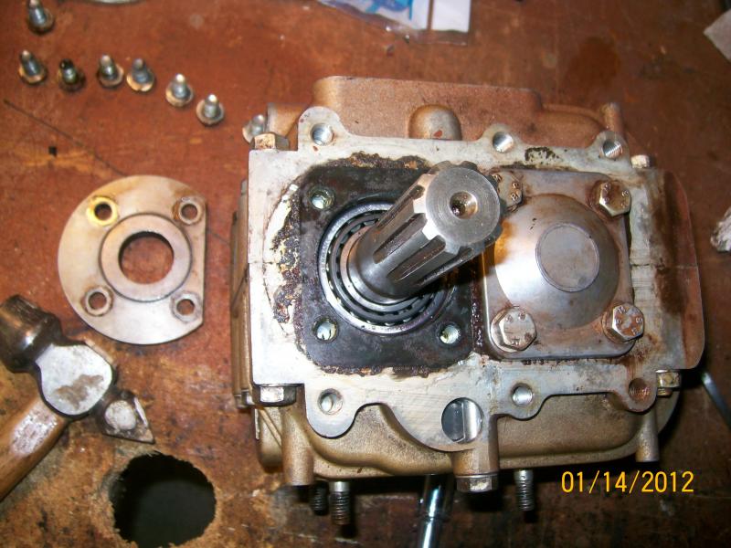

Well it is a HBW50. I pulled it and tore it down. There is a 7.5 mm ball bearing and a spring missing from the clutch pack. They are not in the bottom so it must have been apart before. I found the spring in
Florida. A ten pack of the steel balls in England and the Gaskets and seals in Seattle. Wish me luck.
