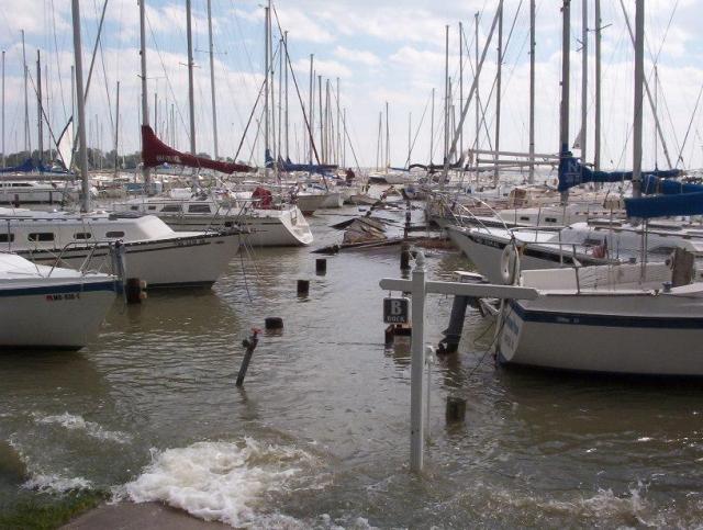

Having thought I adequately secured my boat in its slip (15 dock/spring lines; 8 fenders deployed; all sails and deck gear removed; etc.), my boat was totaled by Hurricane Isabel in 2003 when the dock itself failed. I'm not sure about other locations, but most of the boats that got hauled before the storm fared far better than all of the boats left in the water. Hurricanes are powerful storms that are sometimes powerfully unpredictable. Get yourself and boat as high and dry, and as far away from the their predicted path, as you can.
FYI, BoatUS insurance pays about half the cost of a haulout before a named storm headed for your area.
FYI, read the fine print on your slip contract. In some cases, a marina may require you to move your boat (to where???) when a hurricane threatens the marina. In some cases , you or your insurance company may be liable for any damages your boat may cause to a marina....
