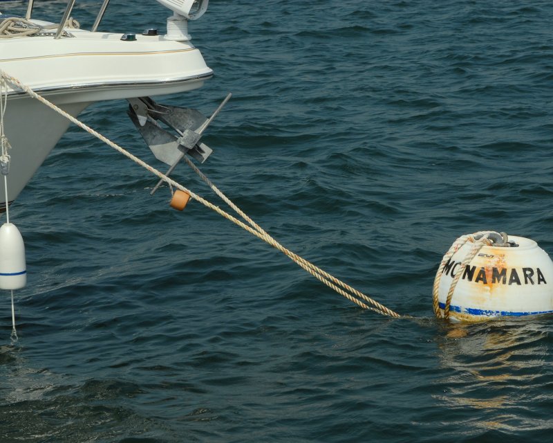

I understand all of the recommendations except about the anchor. Why remove the anchor?
Tim means pull it off the bow not remove it from the boat entirely. When the boat gets yawing up and down the anchor can slice right through the pendant or get the pendant caught over the top of it and then chafe right through the pendant. These photos are less than 30 knots..
UP
DOWN
UP
DOWN
And this is without any wind..
This one did tangle..
Now picture this bow in 4-6 footers..
