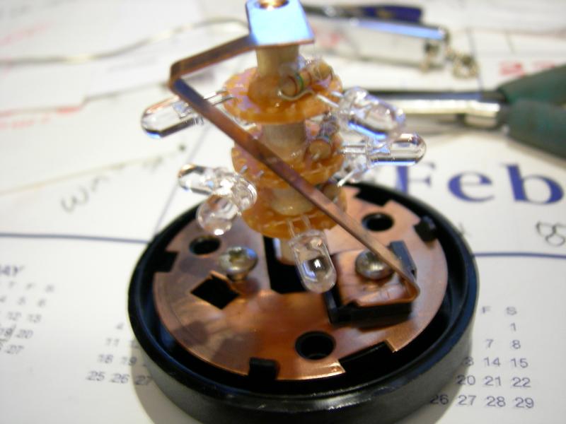

10 years ago I custom built a bunch of mine. The LED's today are Smokin compared to the older ones. Some of my cabin lights I just bought G4 stuff and used the base of the old lights. My biggest challenge right now is my Mast Light needs to be Upgraded (to the newer LED's).

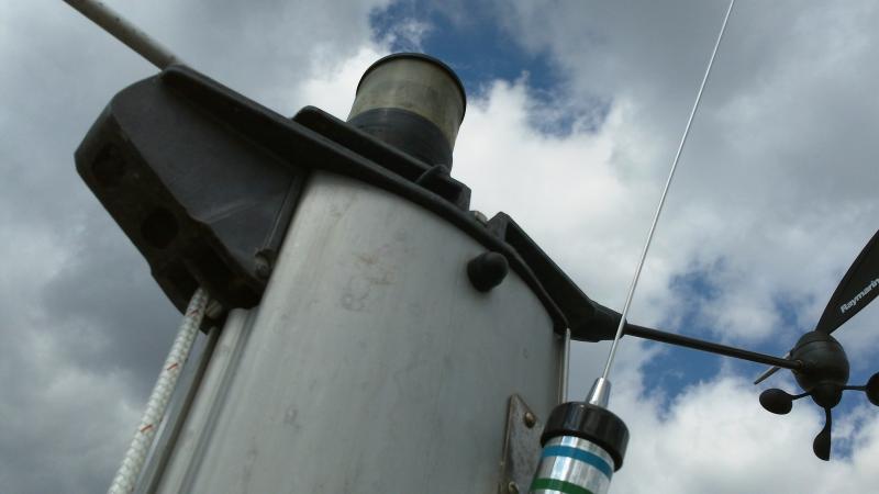

Anchor Light
I too have replaced a bunch of my lights with led. I would like to order an anchor light but I would like to limit trips up the mast, does anyone know the type or a link for the anchor light for a 1998 hunter 410.
Hi, The anchor light I have is a Double Contact Bayonet Indexing Base Bulb. I found a replacement bulb at marinebeam dot com. Type TW-BA15-SM for $18. Here's a pic of my light attached.
