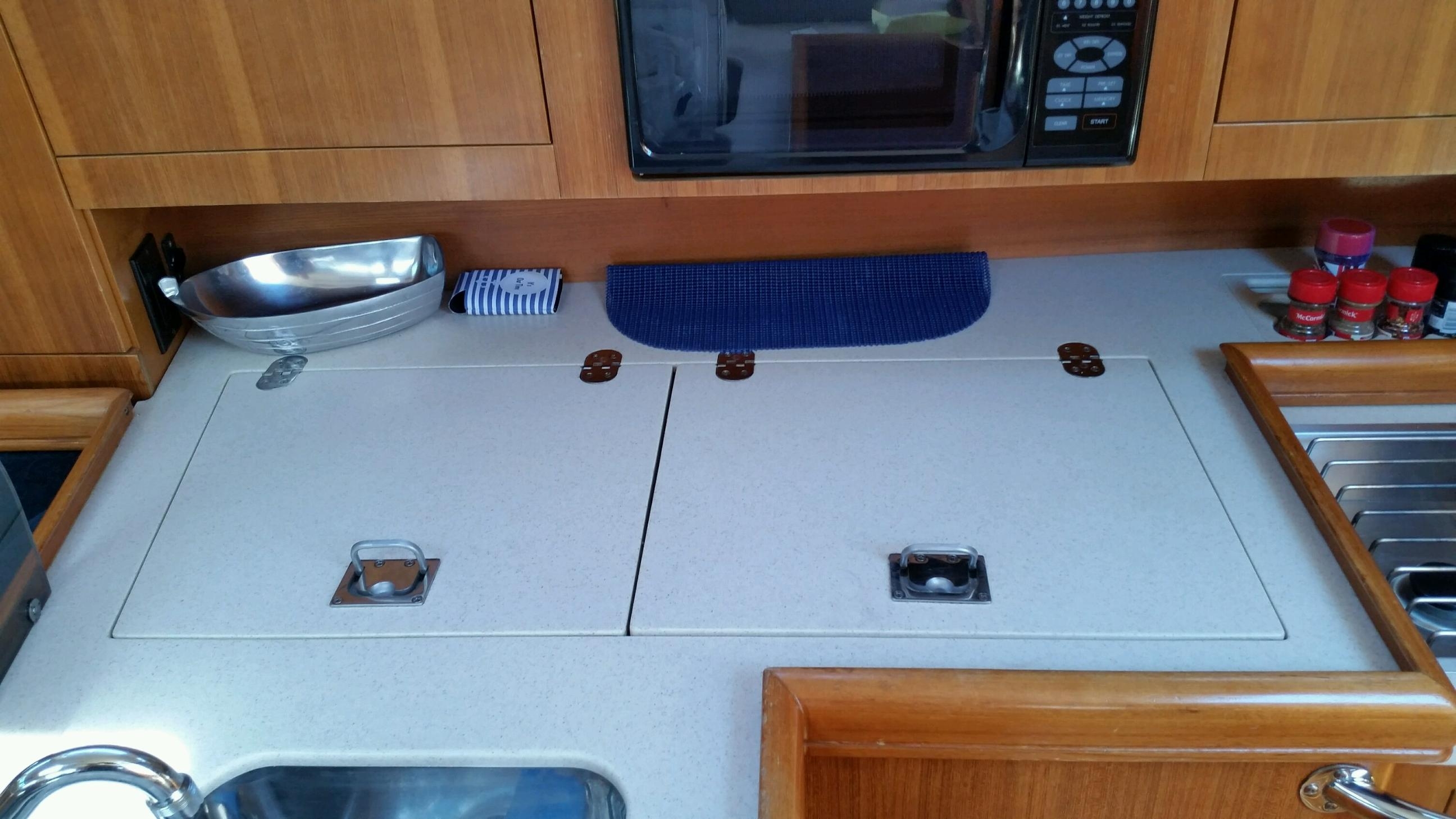

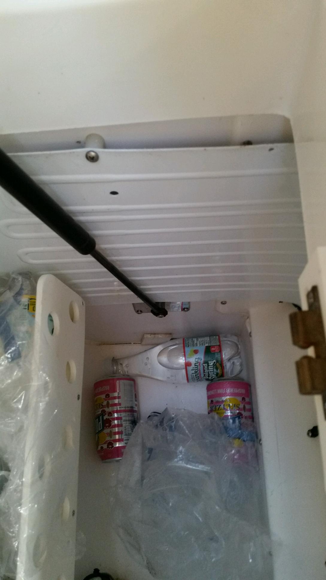

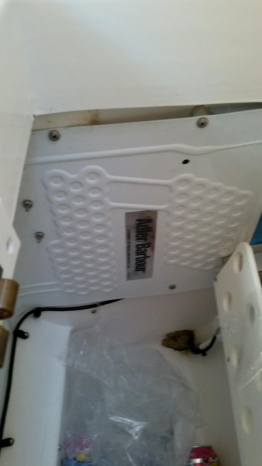

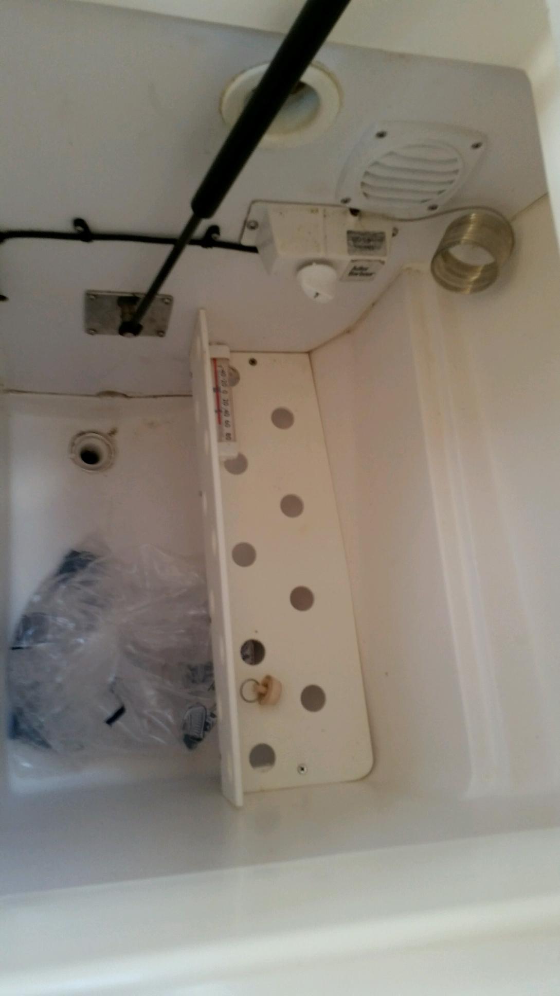

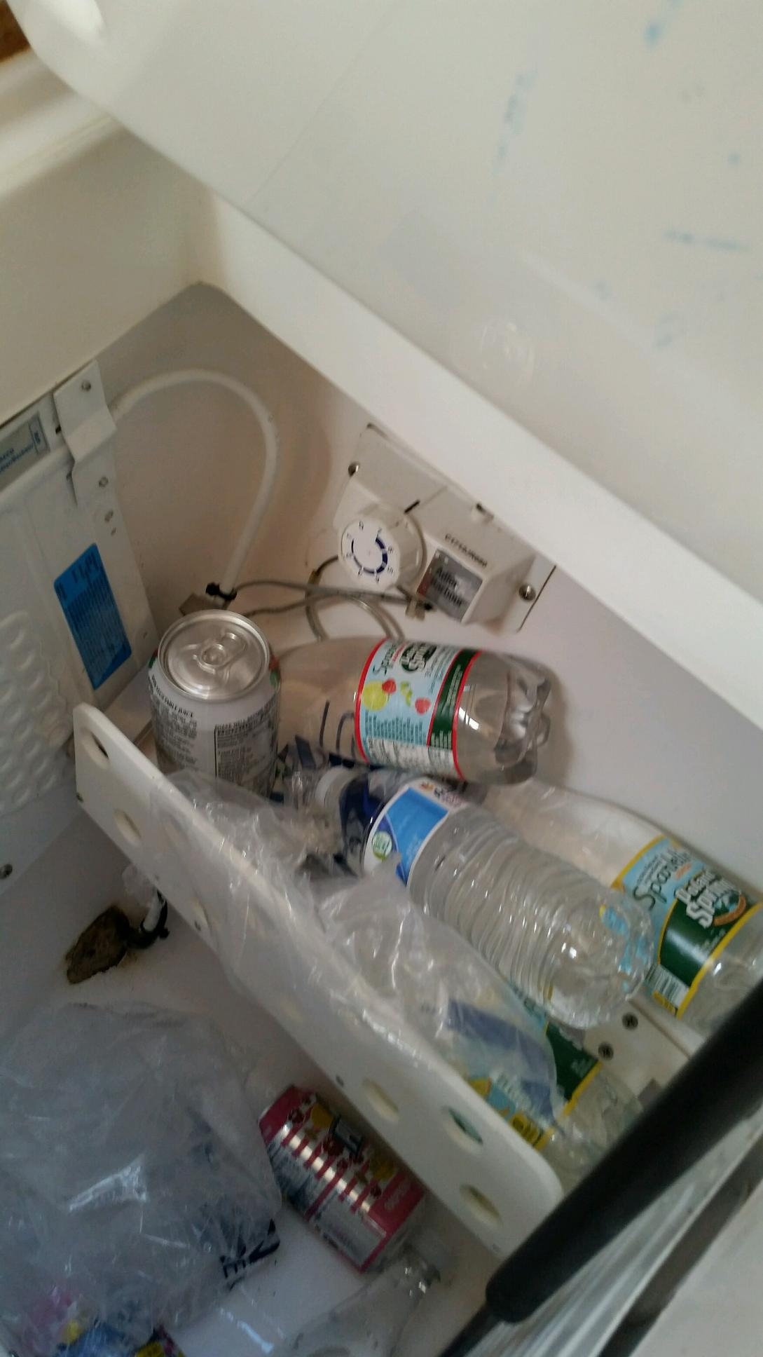

We own a Hunter356 2002. Our freezer and refridgerator (two seperate spaces/compartments) have not been working well. We need to keep both dials on the coldest settings..The freezer keeps ice frozen, however any frozen food etc I put in there defrosts..The fridge has to be at coldest setting to keep temp at safe temp so food wont spoil...We have had freon put in and that does not help at all. Any suggestions? Our thoughts are we probably have to replace the units..(cold plates etc)..Just not exactly sure where we would find replacement...Thank you for any help and ideas you can offer...( I have attached pictures in hopes that helps..They are all labeled boat freezer, however they are pics of freezer and fridge..Freezer on left, fridge on right)...

Dometic picked up the Adler Barbour line. It is similar though I'm not sure it's quite as hefty. I replaced mine with a similar unit as mine wouldn't work on battery. But the old unit cranked some solid hard cold. The new one is OK, but I wish I'd gone a model up.

Just a small suggestion, plug up the drain hole as cold air will escape into the bilge. In any RV place you can purchase a small battery powered fan to create air circulation inside the box.

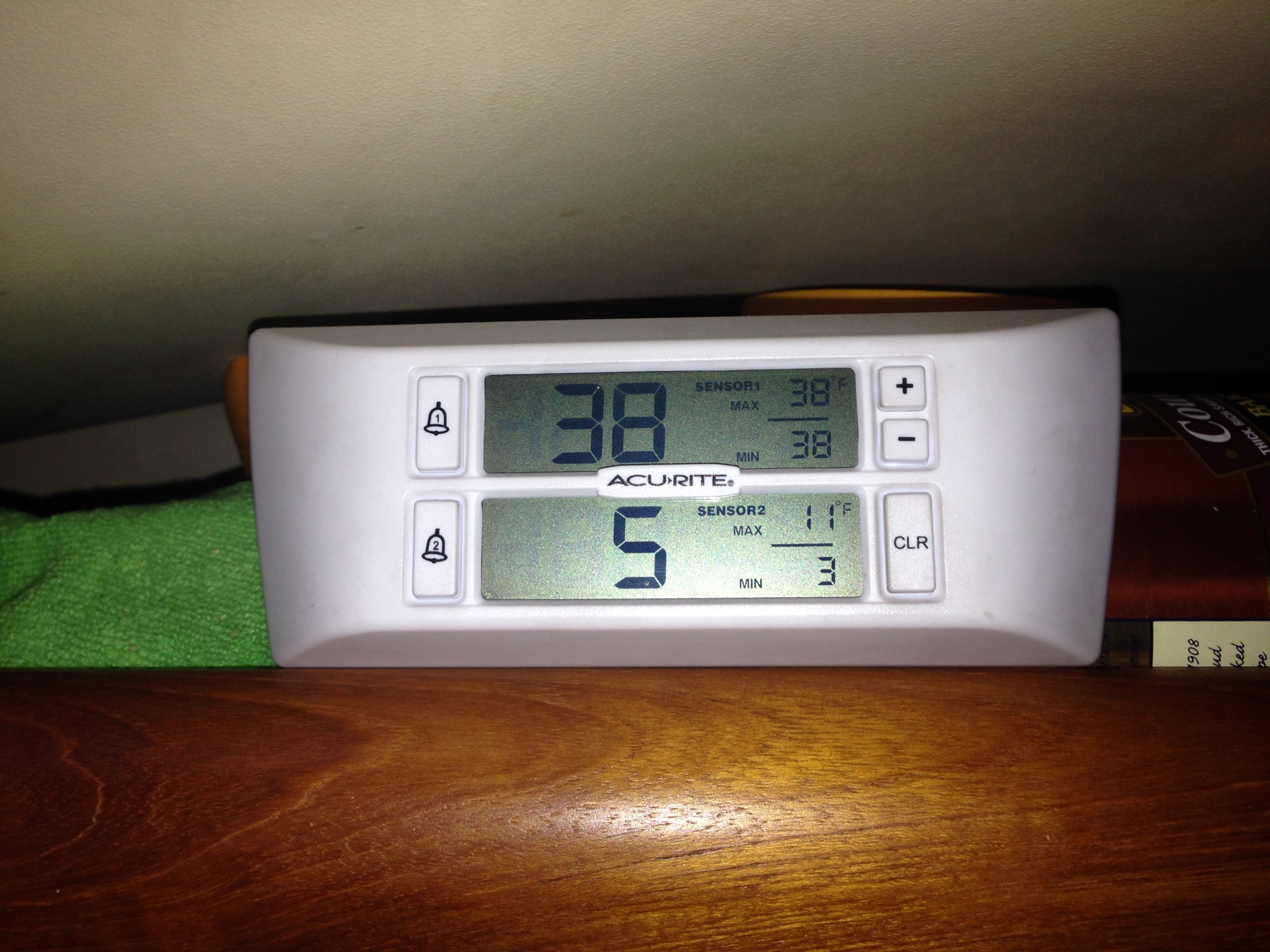

You have to be careful to not put stuff that blocks the transfer hole at the back top right of the freezer as that is where the air moves through to refrigerate. Also, make sure your doors are tight . There are two nuts that keep the latch adjusted. Loosen one, tighten the other and then back the loose nut onto the tight one. Check your gaskets. I also recommend you get a wireless thermometer to monitor both sides. See the one we use in the photo from Acurite. It has two sensors, one fir each side.
