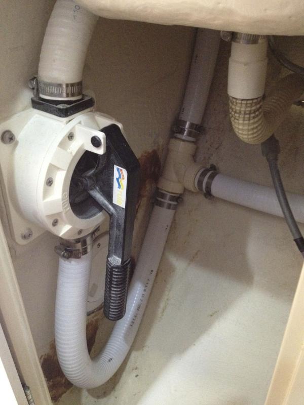

Just getting to posting some pictures of the holding tank install on my 89 Vision 32. It is an 18 gallon tank with a dip tube instead of a fitting at the bottom of the tank. The tech told me 15% of people who order tanks get that style of setup, but my thought was it will never let go and flood my cabin in effluent. I sealed the original aluminum tank located beneath the shower seat and did my best to clean it thoroughly, with vacuum and then bleach. The new setup works well, but do not have the bulkheads in place yet.
