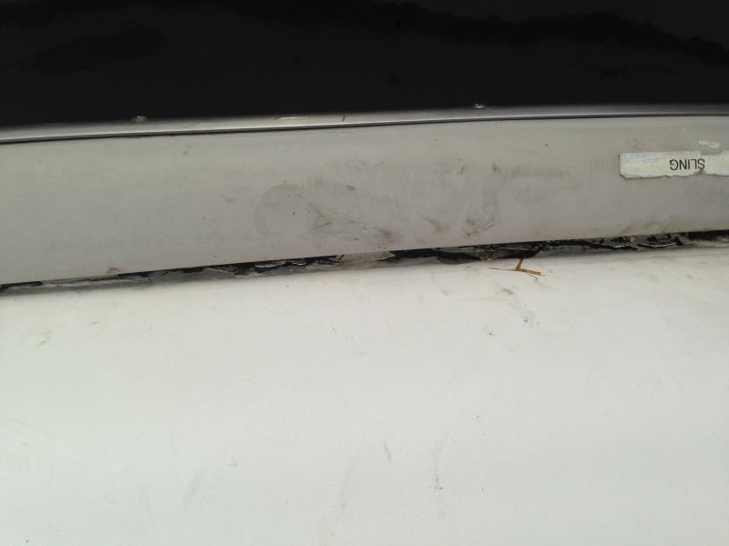

as you can see in the pic , the deck is cracked at the flange along the seam. I can only guess that when the boat was pulled out of the water last year, the pressure of the sling here caused it to crack. Major repair I would guess, especially as it's where the sling is supposed to be set. I"ll probably 5200 it until I can get her pulled and properly repaired.
any ideas on this are welcome

Check manual
I noticed in my 420 manual it states that 2x4 blocks should be inserted just under the rubrail and slings when using a travel lift. There is to much pressure on the sling to rubrail area and can crack or distort the joint.

Well I didn't see that and am pretty sure that's the reason for the failure. Thank you for the info.

Before you do anything I think you should call your insurance company.
And yes the manual does say to put a 4x4 at the sling tp prevent this.
