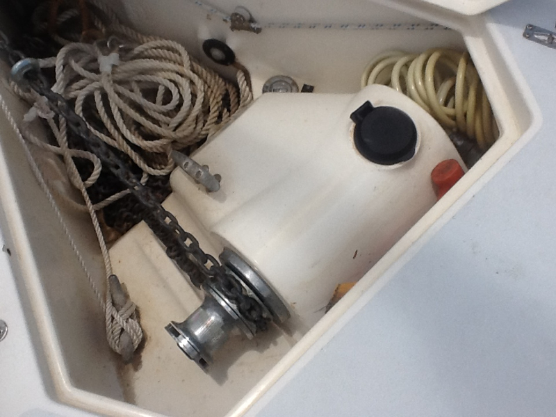

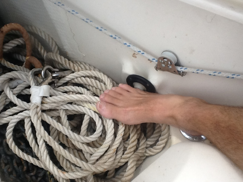

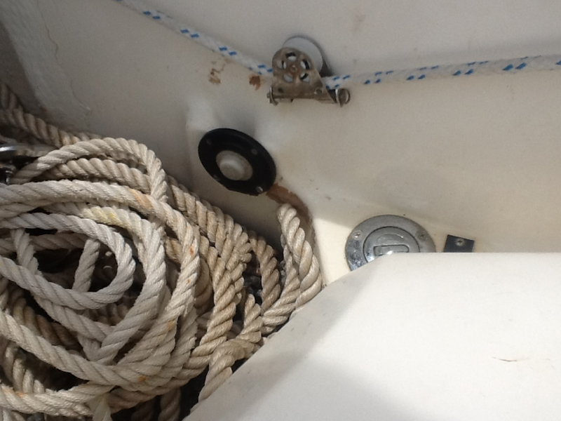

Hello, Our PO had changed our windless so it has a down button on it. I will try to post some pictures of the setup when I get to the boat this weekend.
We have a 42 Passage (1991), the button on top of the hump is our down button, I think this was the up button before, my up button is down in the locker on the starboard side near our bow water tank fill cap. It is set up so I can sit down and use my right foot to work the button and have both hands free to tail the windless and wash the chain on its way in. It works really good. I'm not sure what maxwell windless I have but I will let you know when I post the pictures.

Hello, I'm back with the picture's of our windless setup. Our windless is a Maxwell 800.
When we use the down button we need to keep an eye on the chain as we pay it out, it will jump off the gypsy if not carful. Our windless runs faster then I like! Up or Down! In the one picture you can see how I use the side of my foot to run the up button. Our relay box is mounted right buy the motor below deck. ( sorry no pictures )
I hope this is some help for you.
