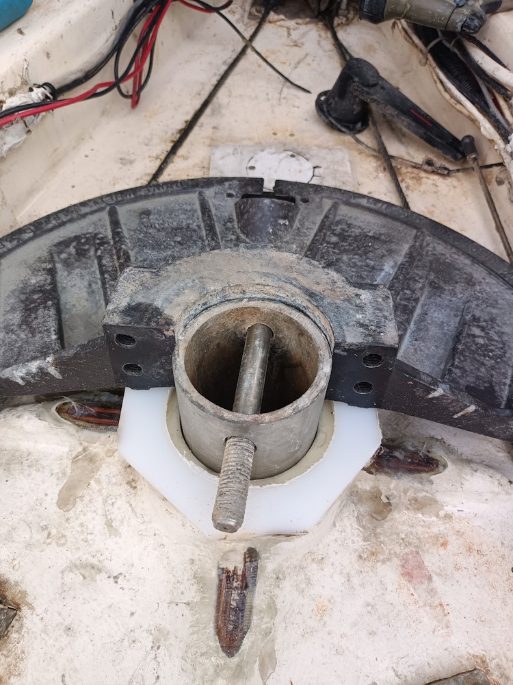

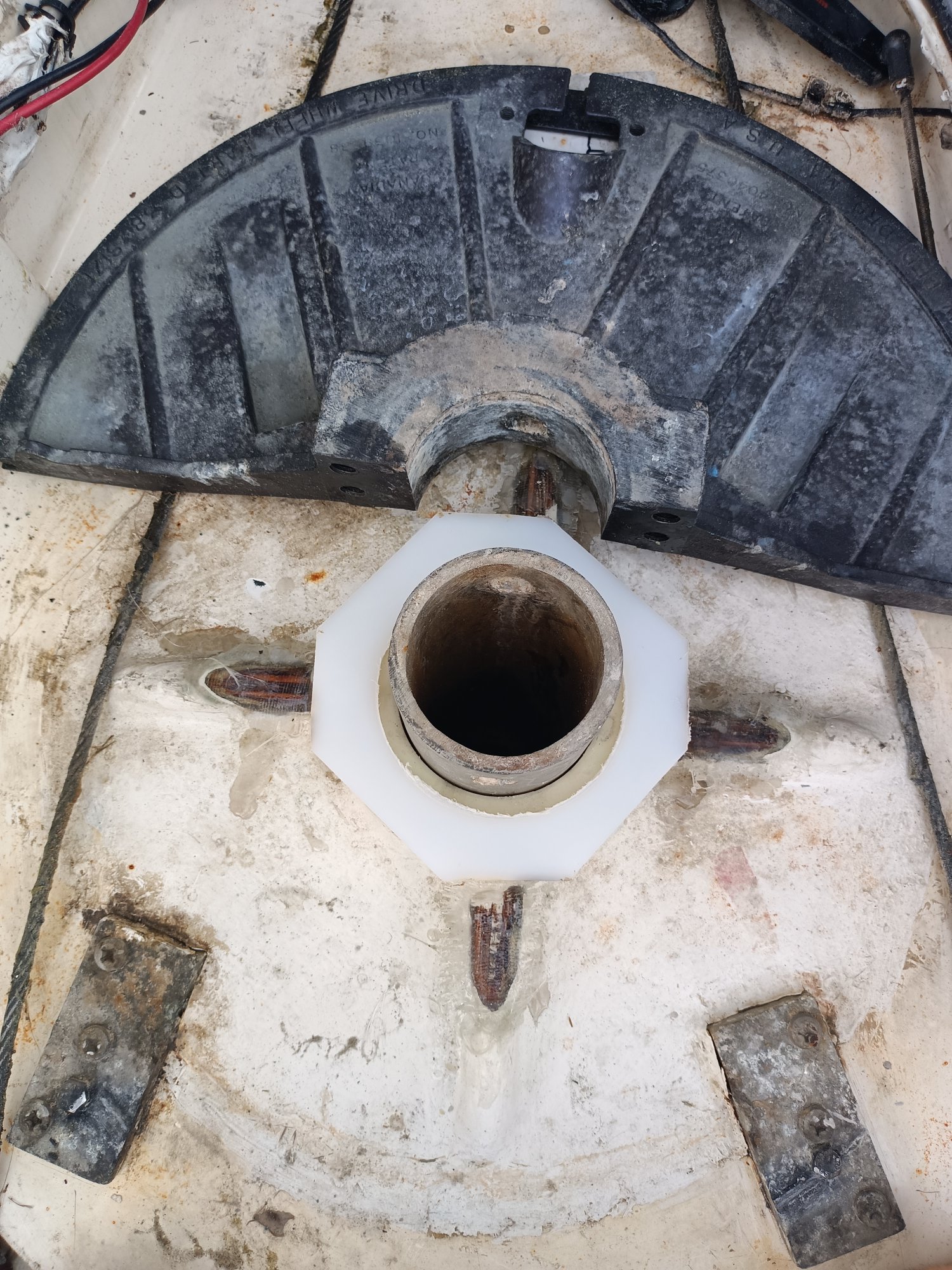

I am looking for drawings, sketches or pics of how rudder stock (fiberglass) connects to the Radial Drive Wheel. Seems that after "meeting" with the floating log I have twisted the rudder stock. From the outside, it looks like fiberglass stock is "capped" with an aluminum bush that has the Drive Wheel on it and is through-bolted for the emergency tiller. Is the shaft of the rudder stock a fiberglass tube? What size? Can the twist be repaired? How?/ik

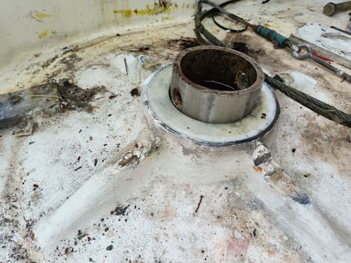

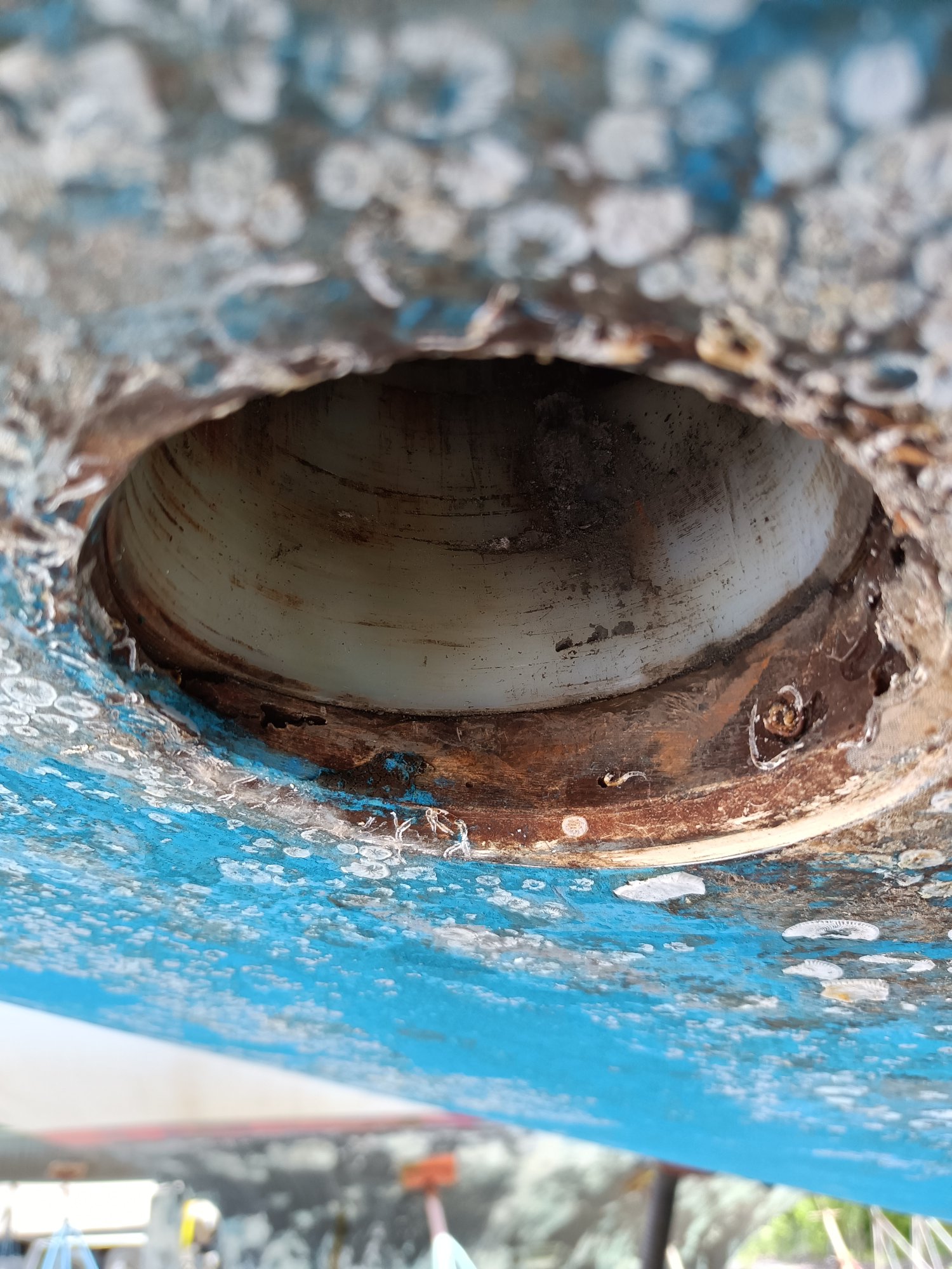

Many thx for the advice. I have the boat on the hard and dry and miraculously when the boat was placed in the raddle and the floor opened, the twist disappear. I would not believe it if I would not have pictures from afloat situ. Examination of the bottom part showed that the blade is in perfect condition, clearance on the bearings is acceptable for further use, and the prop and shaft are intact. Magic? We were digging around but could not find what happened. Using Sherlock Holmes' elimination formula (once all possible are not probable, then improbable becomes possible) we concluded that the steering cable jumped out of the sprocket will. After removing the cable we found that some strings were broken (looks like it worked for 30 years), replaced the steel wire, and assembled it to as new condition. Works well. "Splash" in two days. But deep in my mind, I will have worry that maybe we have missed something.
I must also say that the workshop I engaged in dreaded taking the radiant wheel apart. After 30 years there was a good chance that some parts became welded. trying to open the screws could end up with breaking the radiant, which otherwise looks still in good condition.
So I dodged a big bullet (read the big bill) but did not quite clear doubts in my mind.
