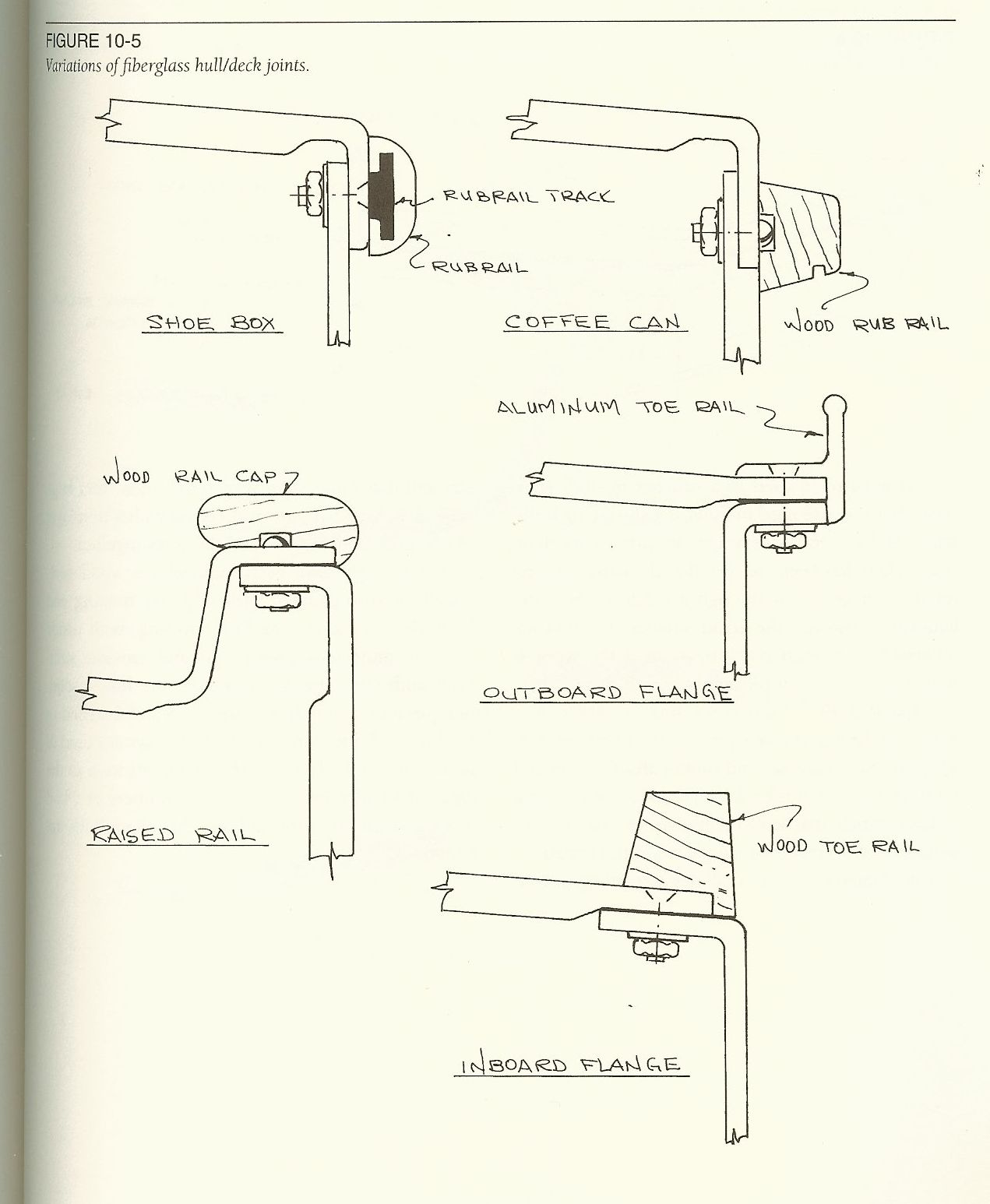

I believe Hunters of that vintage used a shoe-box type glued and screwed joint. If you can describe how it was damaged and what damage you think occurred, others here might be able to offer some advice.

The Hunter boats of that vintage use the "outboard flange" design below, but at the transom I believe it's more of 'shoebox' joint since the toerail does not cross the transom. It's a substantial (3"?) overlap there.. might be a challenge to repair!
