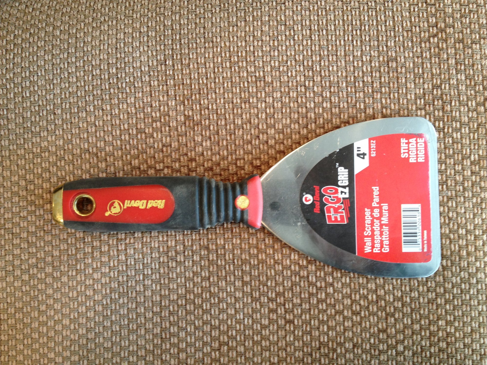

This is my "go to" tool when replacing the headliner. I have a smaller one as well. Note the rounded edges.

Semper, I would be careful putting grease on or near the headliner. If it "bleeds" thru the material it will be ruined! I never had any issues pushing the material into the slots without any use of lubricants.
