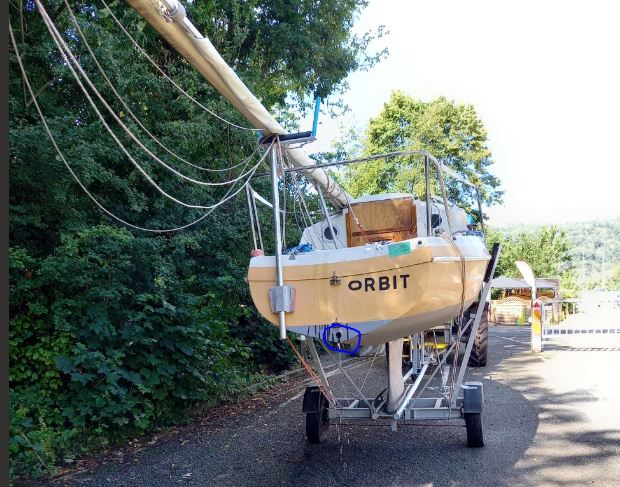

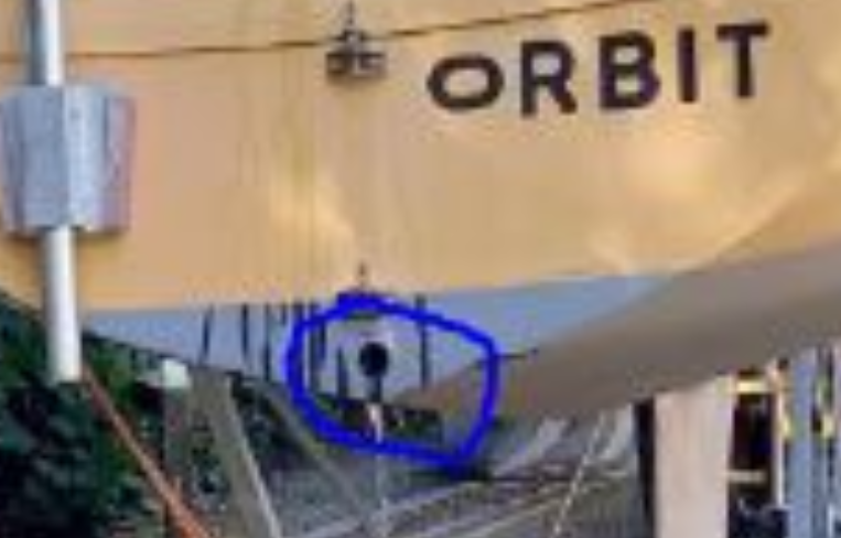

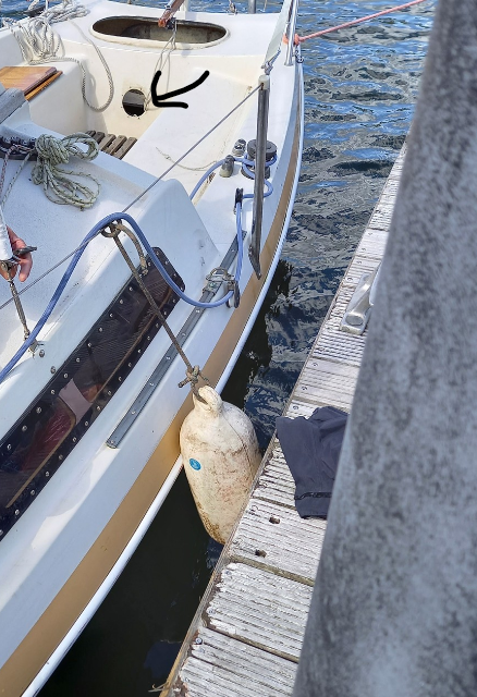

I recently bought a Hunter Europa that I now keep moored on a buoy and just wanted to confirm something (see pic)
Should that plug that is below the waterline be plugged when on the water or left open? If i open the back part of the rear seating area i can see a bit of water below and when i returned to the boat a couple of weeks later it was still the same hence not sure what is best?

Welcome to the forum and congratulations on your new sailboat!!
Transom drain hole below the waterline should be plugged BEFORE the boat is launched into the water to prevent water entering the boat.

Definitely plugged before hitting he water.
If you do want to keep it bone dry back there, purchase a fuel squeeze bulb :
And fit it with a few feet of vinyl tubing to pump out any rain water overboard that may accumulate back there. I carry one and use it for cleaning out any internal water after an internal washdown.

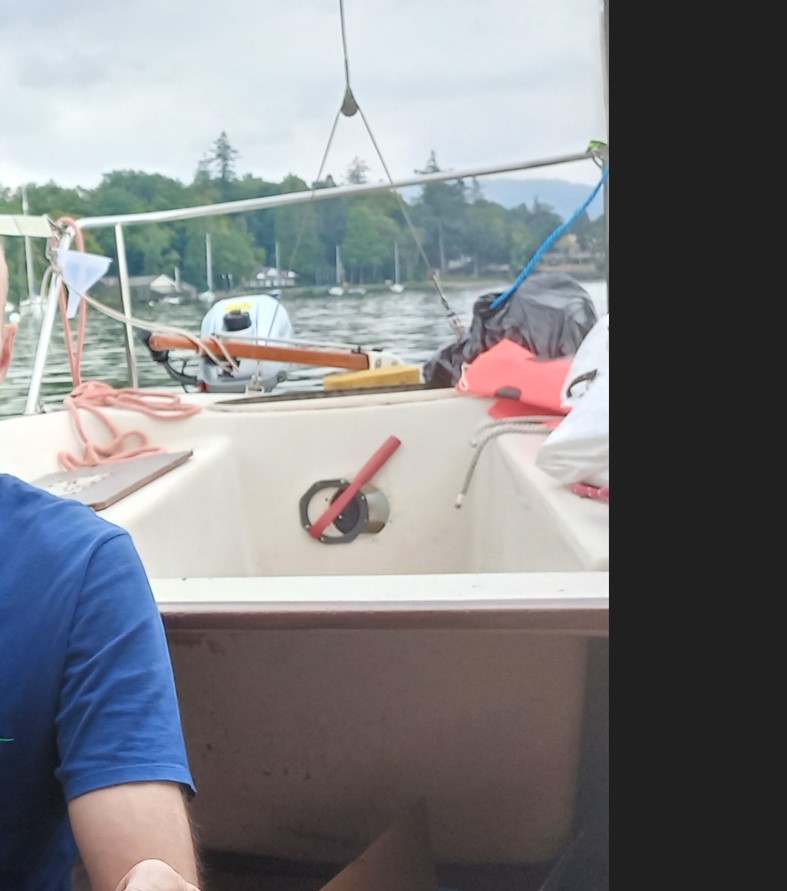

Thanks Ralph will look into. Previous owner left a manual bilge pump to attach so will check how to proceed at the weekend, (see pic where pump will go)

Somehow got the impression that water was around you feet but that's not the case.
Water in the bilge will not bother you. Ensure the pump suction is as close to the hull as practical and you'll never know a small amount of water is down there.

Are we 100% sure that is not the cockpit drain hole? He did say he left it on the mooring open and it did not sink. So I'm thinking that may be the drain hole for the cockpit drain. If that is the case and he leaves it on the mooring it MUST remain open or a heavy rain will sink his boat.
Is there a hose running from that hole to a drain hole in the cockpit?

He DID NOT have a bung in it while the boat was moored. He intends to "get hold of a bung."
That bung hole is well below the water line:
If that had been a bilge drain and left open, the boat would have sunk within the hour when first entering the water.
That didn't sink the boat. But if he plugs the hole, that WILL eventually sink the boat.
@martx007 would be well advised to investigate this very thoroughly.

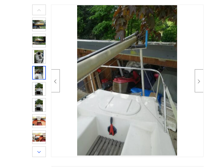

Thanks guys, its definitely bilge pump hole as there was one there before purchase but broke and i have the new one on the boat to connect (see pic of advert for sale) so outside hole must be to plug? :eek:)
the big hole in the rear of the cockpit is definitely a mounting hole for a manual bilge pump.
That Bilge pump would output to a hose outlet above waterline.

thanks for the links! i think there is actually an outflow for the bilge. On 1st pic of this thread top right of transom . Will concentrate on this at weekend, nuts and bolts should have arrived by then to install pump

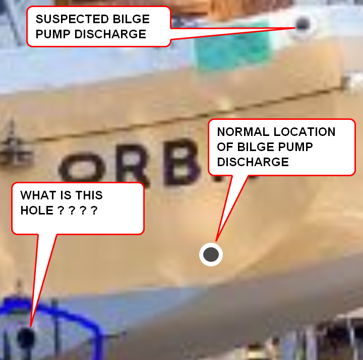

Looks pretty high for a bilge pump discharge. Usually they are near the water line for pump capacity. No way of telling what a previous owner may have done.
If it were my boat, my #1 priority would be to determine the function of that external, below the water line hole shown in the blue circle. I would put this above anything mechanical, electrical, or cosmetic work on the boat. At this point, we have no clue as to what its function is. As your boat is on a mooring, no one will be passing by and notice any problems.

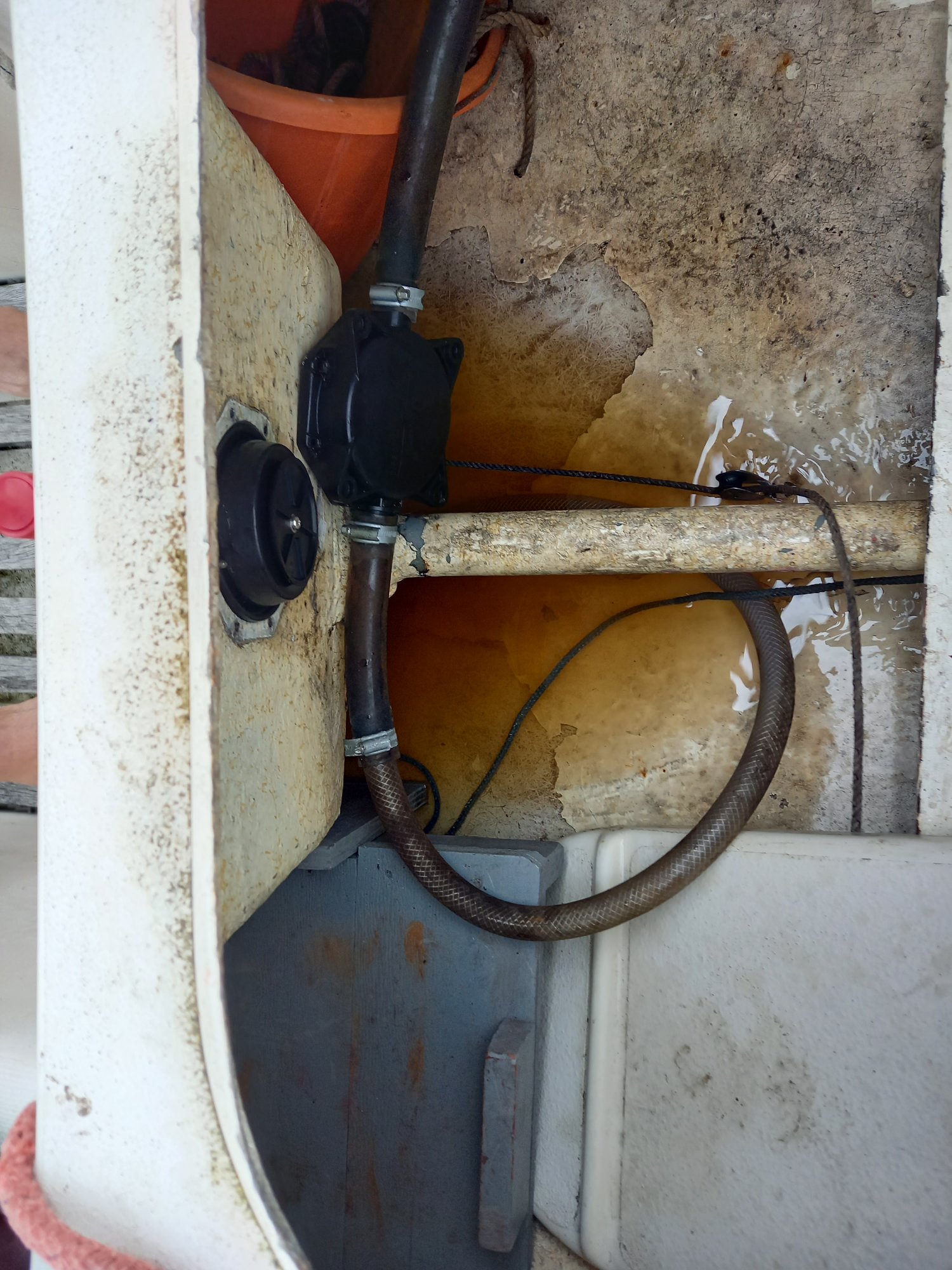

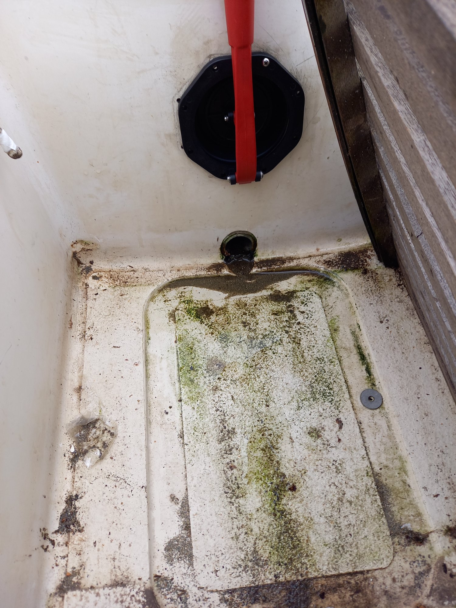

The hole top right of transom is indeed connected to the bilge pump hose. The hole at/below waterline is in the form of a tube the connects to hole at the bottom of the cockpit(see pics). I didn't take the correct length bolts for bilge pump :( so will be back next week! Any excuse to make a coffee and toast on the lake :)
Inside underneath the transom seems an enclosed space so hopefully wouldn't sink the boat anyway.

Sorry Ralph i should have said there is no need to block the hole at the waterline as it must empty out via the cockpit hole.
