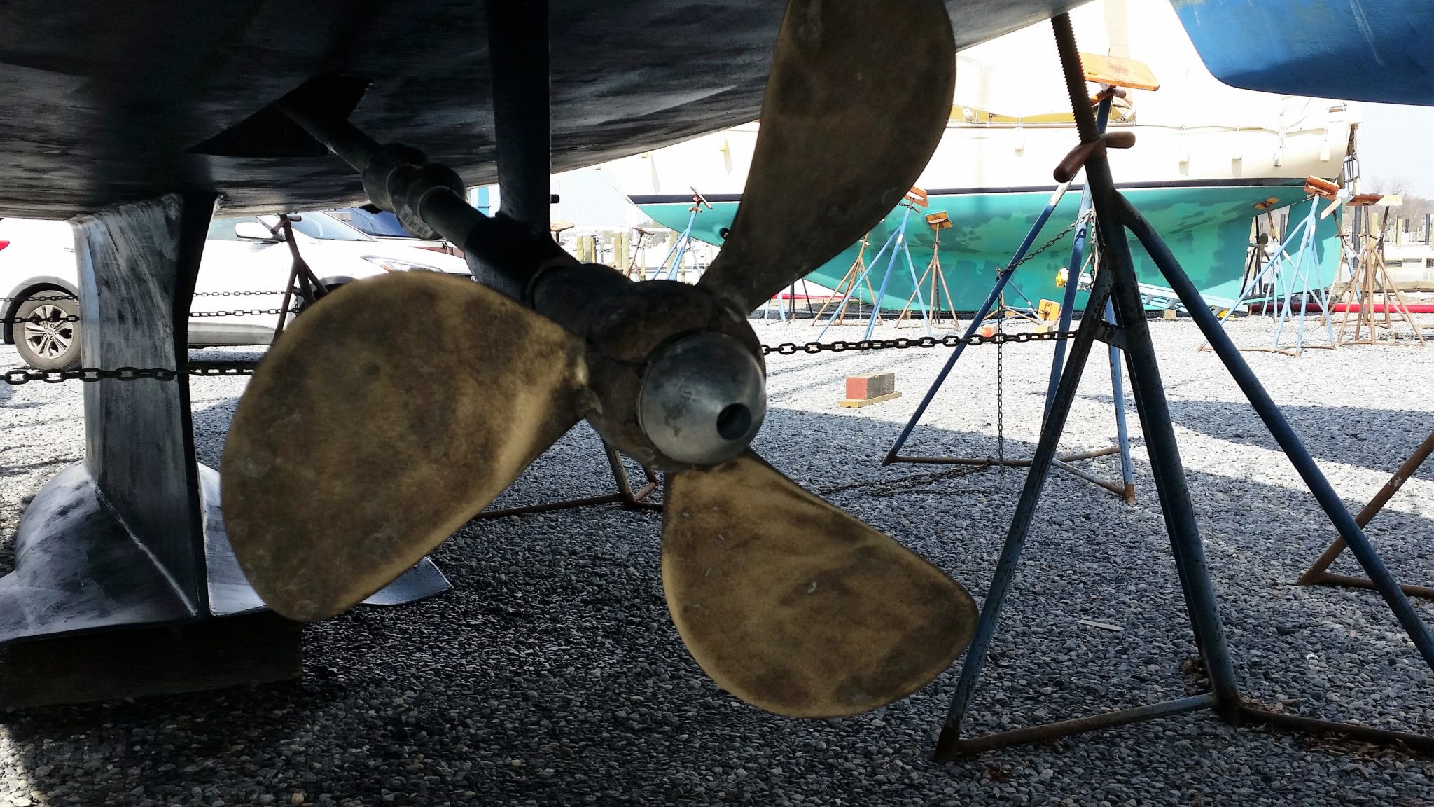

I recently acquired a 2012 Hunter e36 Hybrid with an Elco electric motor and a Fischer Panda 7.5 kw genset. It doesn't have a sacrificial zinc on the prop shaft, and no usual mounting point for one. Does anyone know what the factory set up was on this unique model?

What an interesting question. I can't wait to read some of the responses from them that knows. Elco has a good reputation. I'm wondering if maybe the prop is a composite material and doesn't need an anode.

I just thought of another option,
There are anodes that affix to the end of the prop shaft.
-Will (Dragonfly)
Right! Electricity is electricity and so I'm thinking that you need an anode someplace or anytime you plug in at a marina you will have problems.
Will, that's exactly it! I revisited the survey and it says (1) Shaft streamline type, and (1) Propeller nut type. Thank you for chiming in!

I understand that it is possible to put a charge into a shaft, while plugged into a marina power supply, that gives up electrons, just as a zinc anode might. Basically you can create an electrical anode that does what a chemical anode does. No changing sacrificed zincs, no worries about degrading contact.
