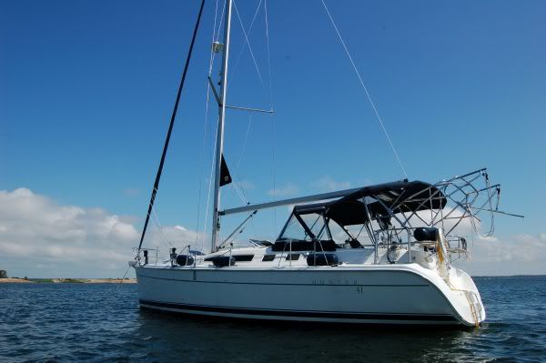

Nick, this is on a H41 in our area. It has two arms attached to the arch that supports the davits.

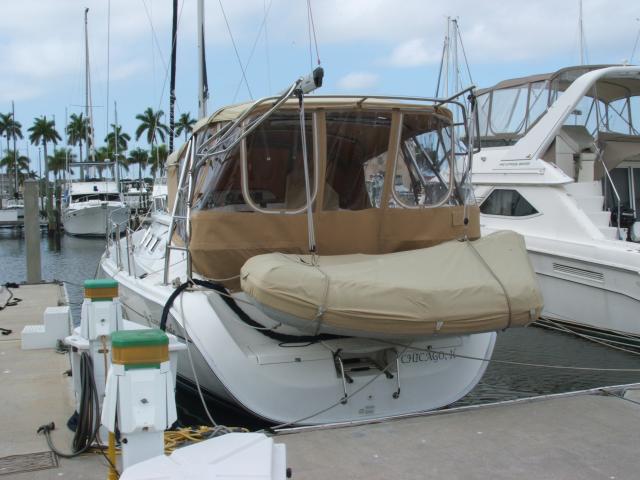

Escapade is a 41DS. We had the Hunter davits installed before we had the canvas done. So, placement of the bimini bow mounts was dictated by the placement of the arch connectors (2 per side). The picture below is included so you can see the dinghy in place. We stern to all the time, but use the finger pier to get on and off the boat. But..........if you raise the dinghy all the way up, there is about 4 feet of clearance underneath. So, you can, with a little ducking, get on and off the boat across the stern.

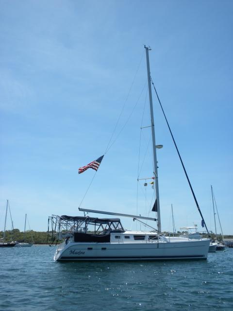

I have the Hunter davits onmyr 44 DS and they work well. I have an AB 10.6 with 15 hp Yamaha and hoist the dinghy flush to the davits easily with a 6 part tackle. Then you are able to board from the stern if tied stern-to. However, the dinghy does then overhang the dock, which your neighbors or the marina may not care for. Here is a somewhat faraway, but zoomable pic so you can see how they attach and how the Bimini works. I also have a full enclosure which is not shown here.

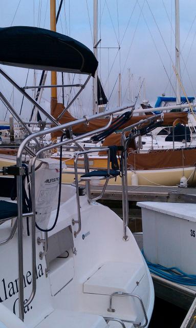

Phone: 410-269-1218. I just purchased Garhauer’s 1-¼” diameter dinghy davits at the SF sailboat show for my sailboat. Good value.
Attached photo shows dinghy davits on a Hunter 36, which docked in my marina. Please let me know if you would like more photos.
