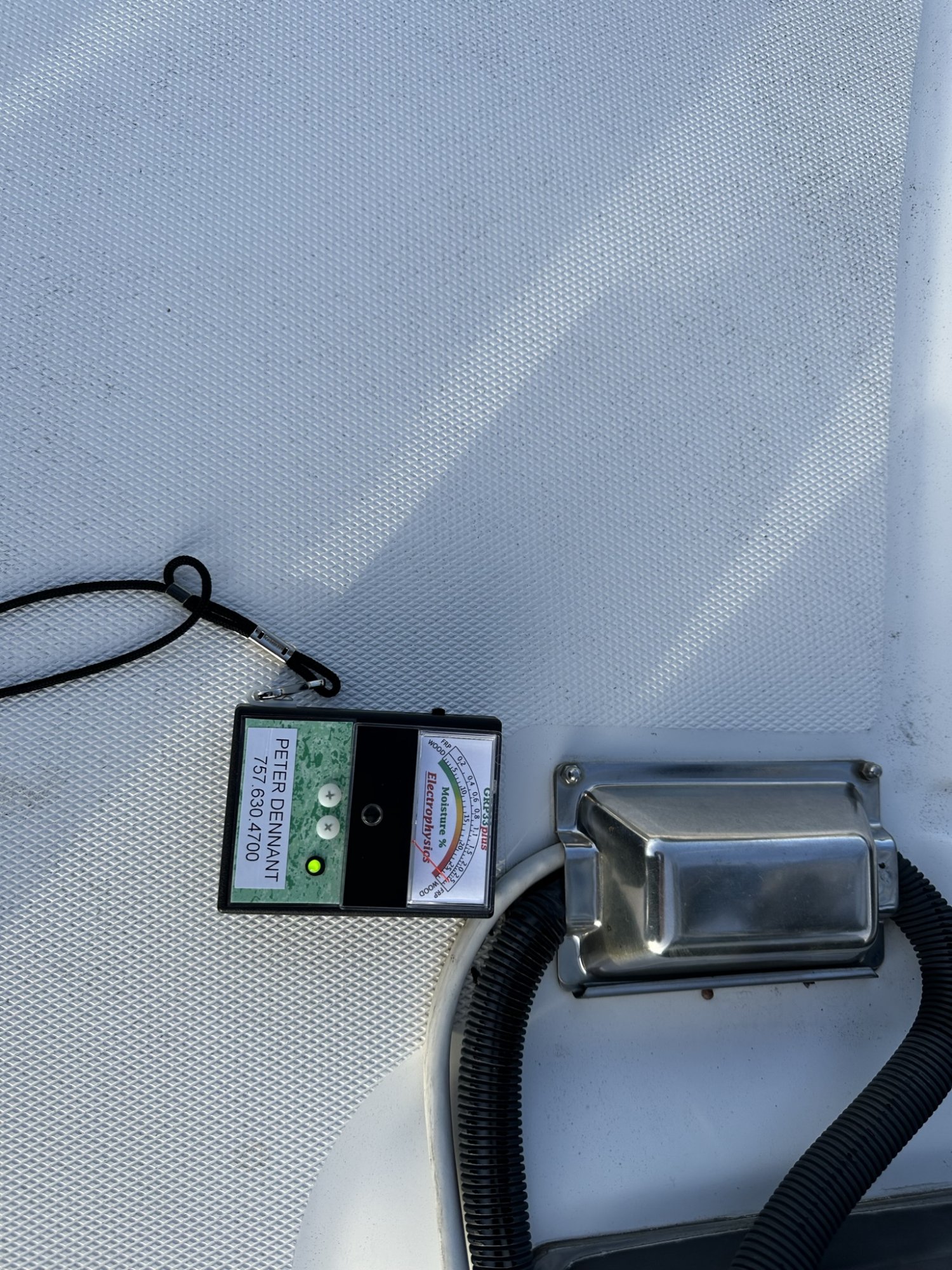

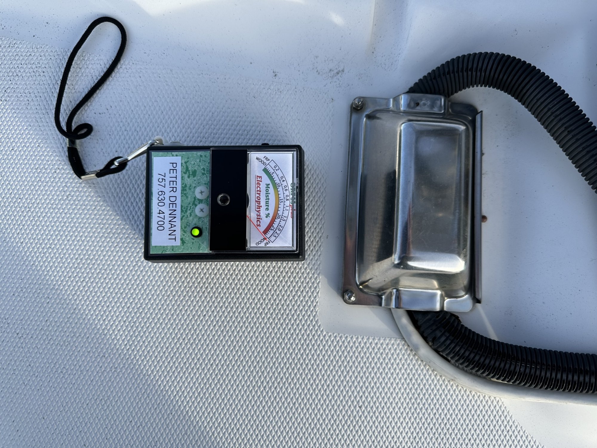

After saying goodbye to my 1996 376, I am in the market for a new Hunter...this time looking for a slightly larger & younger model. I saw a 2005 44AC last week and a 2007 45DS this week. Both show elevated moisture levels around the mast cable port just to the starboard side of the mast (this is where the cables that exit the mast tunnel below deck). After finding this problem on two similar boats in two weeks, I suspect Hunter did a poor job sealing the cored deck from water intrusion through this port. Has anyone else had this or a similar problem? How did you deal with it?

How far away from the fitting did the meter show that moisture? Were you able to measure the moisture on the inside to the same circle on the deck?

Thank you for your response. I have an update: The current owner and I opened up the cable port to take a look at what was going on. We found what is S.O.P. for Hunter - they cut a hole through a cored deck and do not seal the core around it. It appears that this cable port does what it was designed to do which is to keep water from entering the boat. But, because the core is not sealed, over time it wicks moisture into it. In this case the moisture readings are high within a foot of the cable port and fall off sharply from there - generally moving down the slope of the deck.
The core has not been degraded but, as shown in my previous pictures, does register high in moisture content. Once I take ownership of the boat, I will remove the cable port and rebed its fasteners insuring no water is entering the core through these penetrations. Then I will attempt to dry out the core with prolonged, gentle heat above and below the deck. Hopefully I can get the moisture content down to an acceptable level before sealing the core around the deck penetration.
