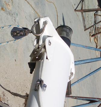

Hope you alread have the answer to your question. Here is a photo of the spinniker bale on my Hunter 36. Halyard is all exterior. There are 4 sheaves, two forward and two aft. Only two are used on my boat.
Jim

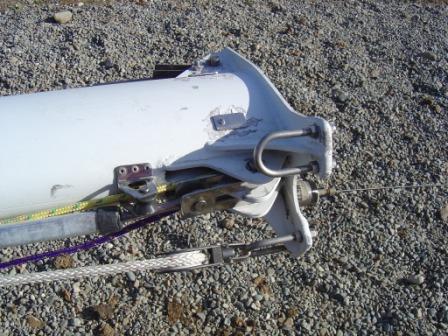

Attached shows the masthead on our 82 H36. We have the dual spinaker bales. I arbitrarily use the port bale for an asymetrical spinaker. Tried running the halyard through the spinaker block and down through the spare port forward sheave to keep it inside the mast. This didn't work as the angle to the spinaker block from the sheave was bad. Spared that halyard and installed a halyard running external to the mast. Works great. Also added a couple cleats near the base of the mast to tie off the halyard and other stuff.
Mike
s/v Charisma
Coeur d'Alene, ID
PS: Mast is unstepped and boat is on the hard for repairs/maintenance.
