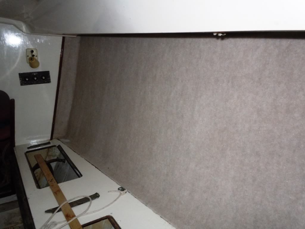

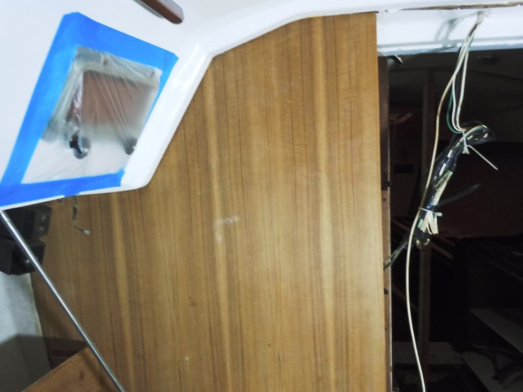

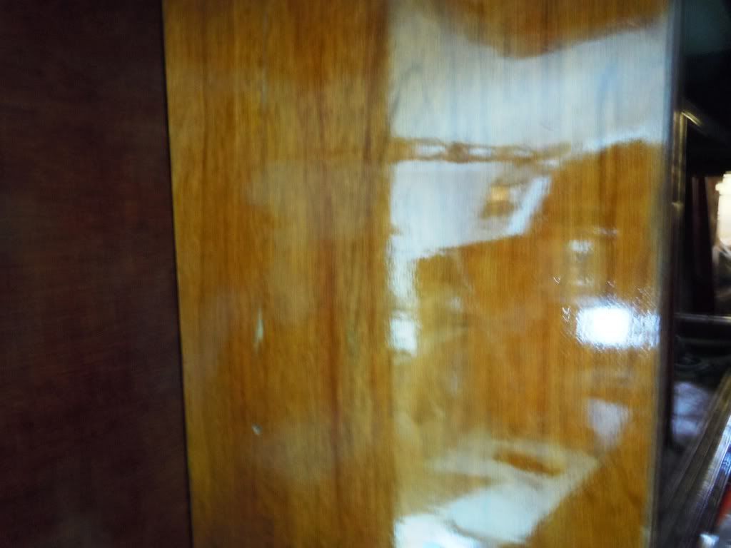

The interior is starting to go back together after all of the pieces were cut, including three bulkheads and the port and starboard salon parts (all of them).
Here are a few shots:
Aft head

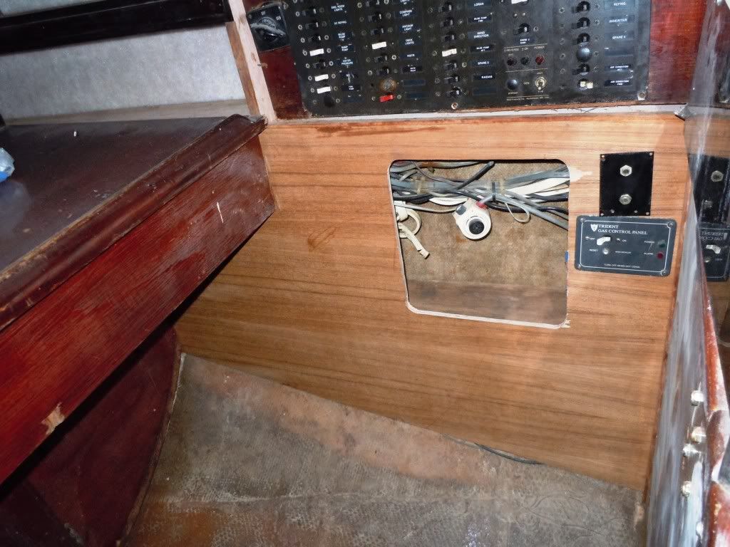

Nav area
Aft berth bulkhead
Aft bulkhead (no flash)
Forward berth

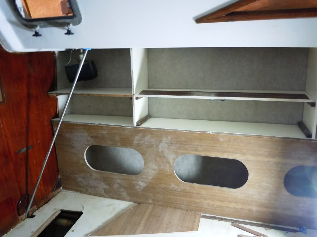

Starboard settee shelving (not trimmed yet)
Forward salon bulkhead portside (not stained yet)

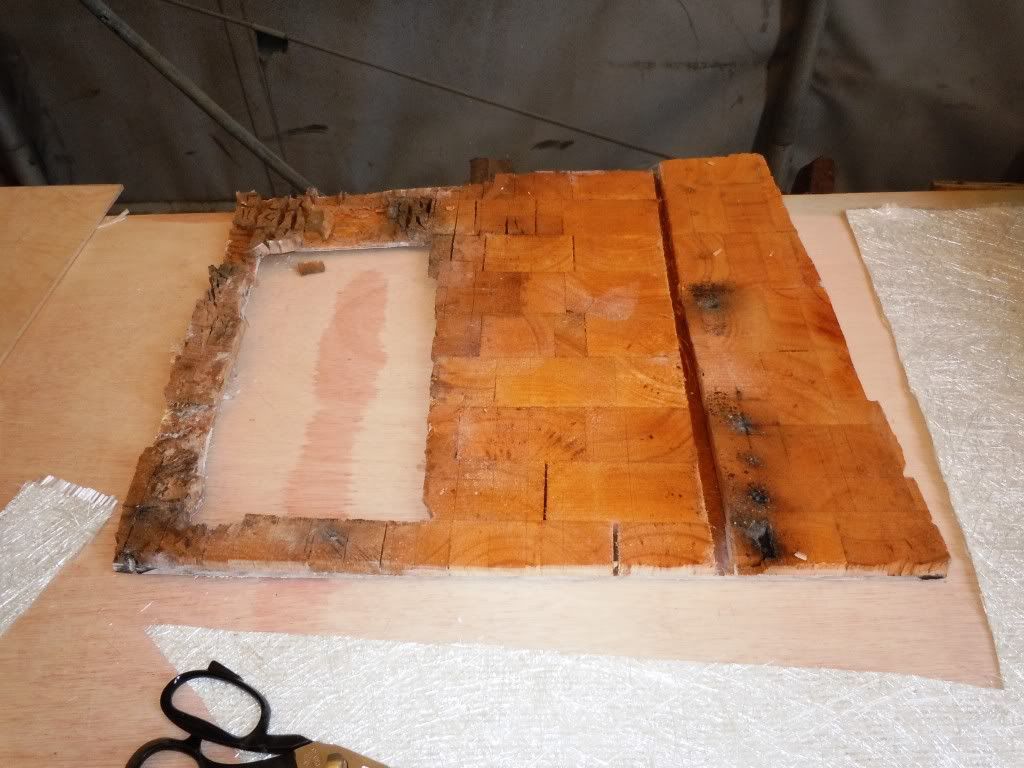

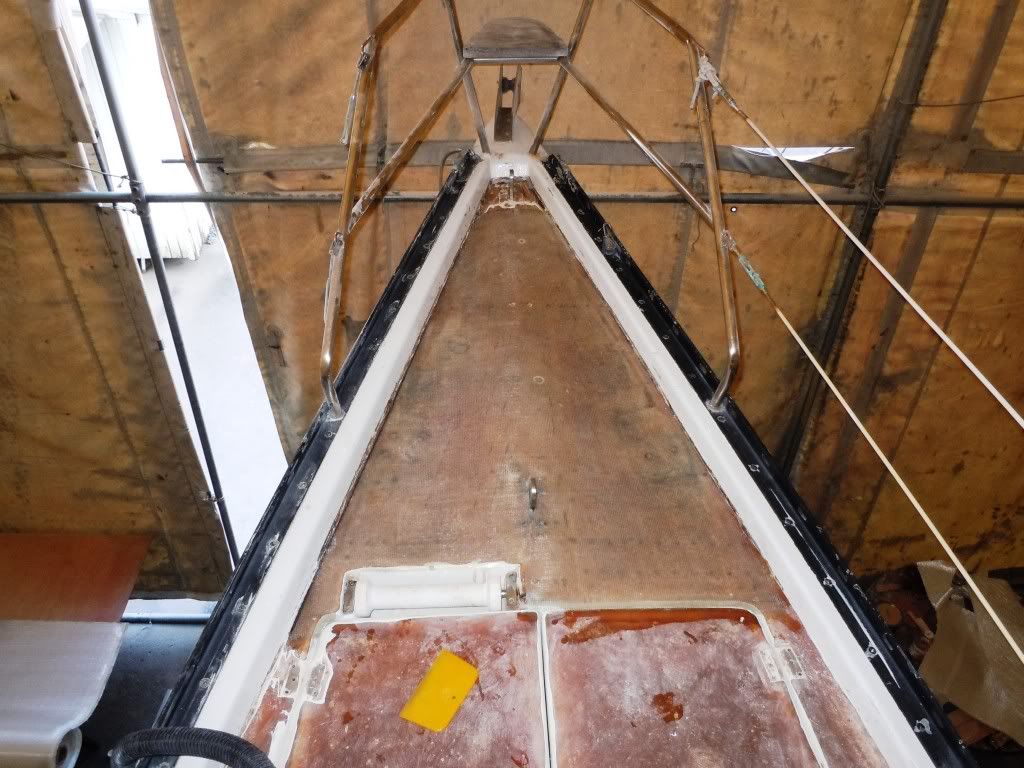

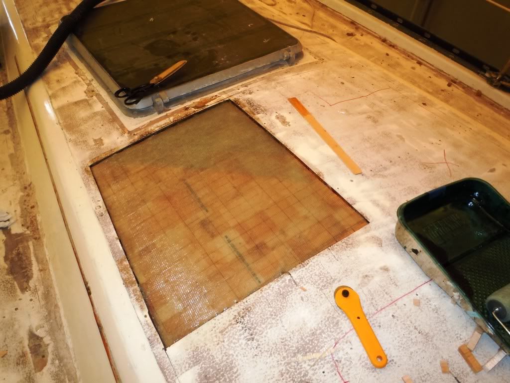

Then there's the deck

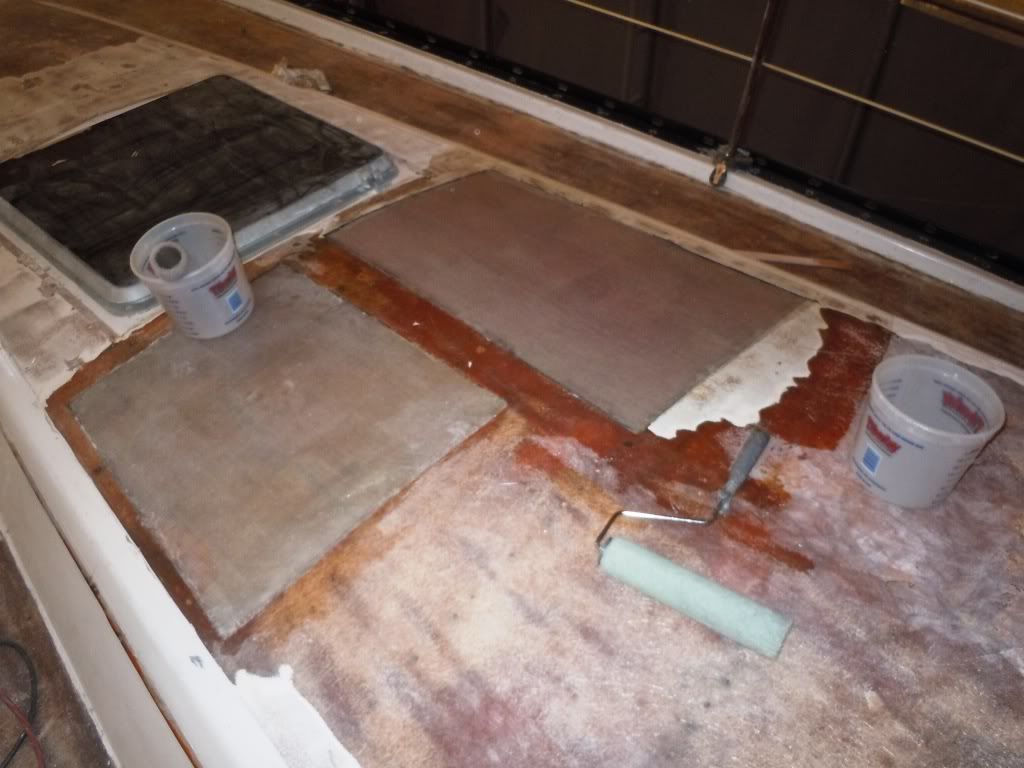

Here's some core work shots

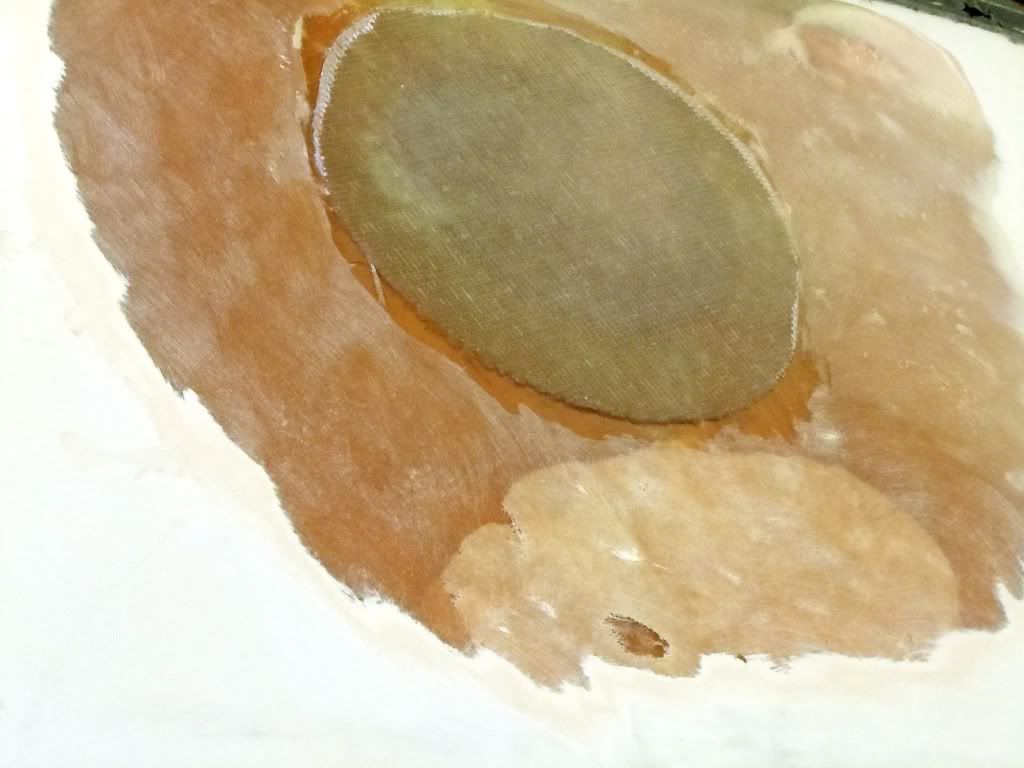

Fresh core and glass
More core work
Foredeck
Hull (needs fairing yet)

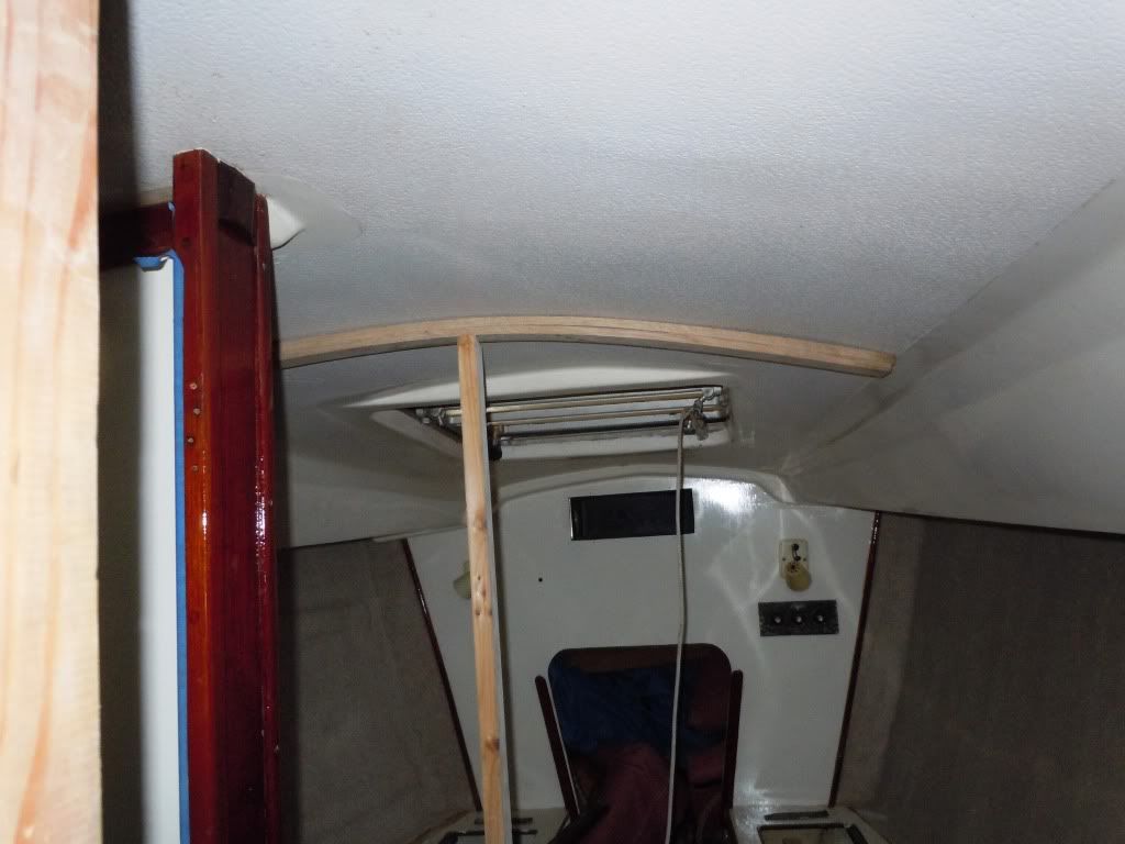

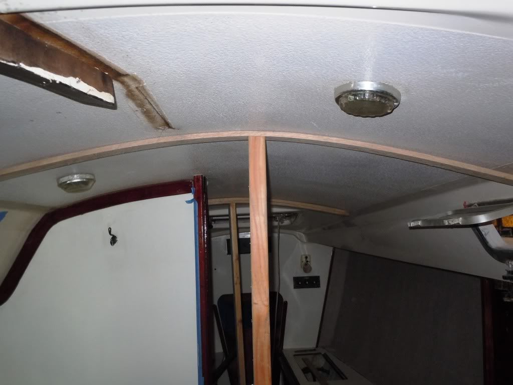

This is the system I used to maintain the camber of the housetop
and
