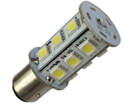

I have a 2011 Hunter 50 and am wanting to change my anchor light with a dusk to dawn LED lamp. My question is this, in the information from Marine Beam, their LED light states this:
It is a drop in replacement for your existing Aqua Signal, Hella, Perko or other anchor light or tri-color housing with a BAY15D bayonet base (double-contact, offset pins) socket. No extra sensors, wires, or switches needed.
I have not gone up the mast yet, does anyone know if the OE fixture is one indicated by their statement? I am trying to limit up the mast to one trip and if anyone knows for sure that this LED light will work, I will order and have it with me for when I make the trip up the mast.

Good morning, Keith. Different model boat and not one to bet my life on it, but odds are that being a Hunter brand boat, it will fit nicely. I converted to all Marine Beam brand LED emitters for all running and internal incandescent lamps. I went with the traditional anchor light emitter rather than dusk to dawn. It looks identical in description and appearance to your posting.

FYI, both my Marinebeam dusk/dawn anchor light and bicolor bow light failed after 5 years of minimal use. Both had condensation inside. Maybe their bulbs are better, but I wouldn't buy another fixture from them.

Hopefully they have improved and will have better luck. I actually could not find another brand that was supposed to be a drop in replacement.
