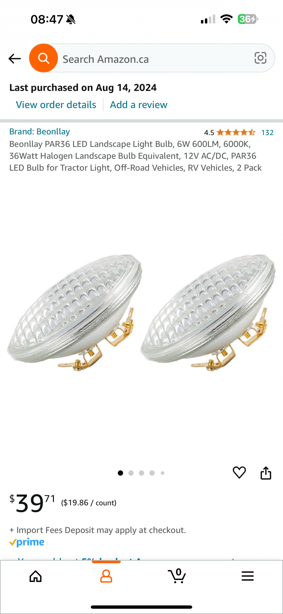

I just replaced mine. I just bought some on Amazon as I didn’t see them here (par36 landscape lights) Mine was held in place by two flexible snaps. As in the bulb is just pressed in and the clips hold it in place.

Yes, it was 100% plug and play. It’s quite a bit brighter. And I’d say whiter than the old one which was kind of “warm white”?
I threw out the old one, but I believe the back was labeled GE 4406 tractor bulb.

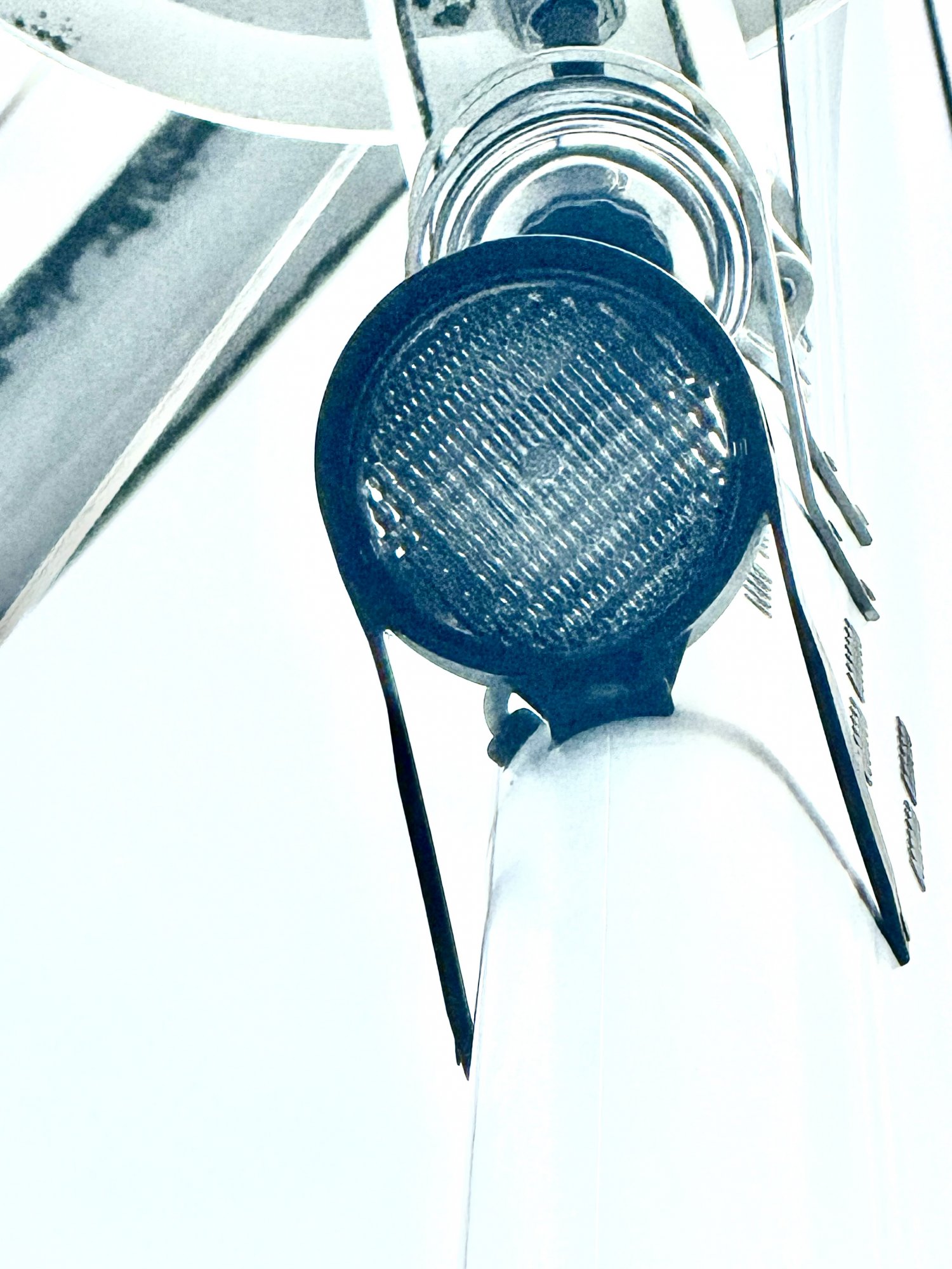

Same here. The install is pretty simple. You need to bring a screwdriver up with you to remove and reattach the wire leads that power the light. Other than that, it just clips into place.
