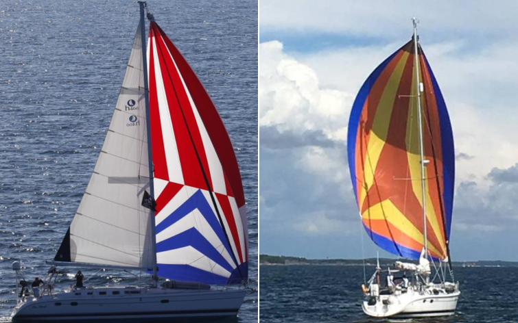

When looking at these yachts online, seems very few have a asymmetrical spinnaker. How are these hunters at sailing down wind?

2. My Hunter 46 has a spinnaker halyard so previous owner likely flew one. An asymmetrical spinnakers cannot sail as deep down wind as a symmetrical sail with a pole. However, they can be flown at higher angles of reaching and can make up for the lack of down wind capability with more reaching speed. I flew one on my Hunter 386 with same winch set up and top down furler that was deployed and doused from the cockpit, albeit it was a fractional rig vs. Hunter 46/460/466, which is masthead so might need to consider what you need to do clear the jib stay........maybe a tacker is all you need. Photos below of a 460 and 466 flying an asymmetrical spinnaker.
