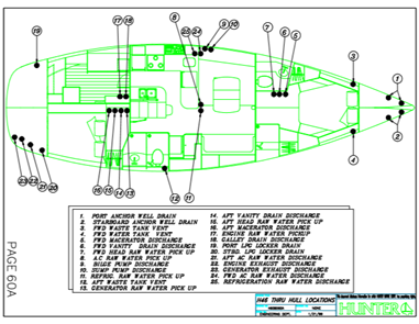

Boat does not have AC raw water pick up thru hull #8. Can the forward head raw water pick up thru hull #7 be used with a tee and separate valves to the AC and head, until the boat is hauled for its next bottom painting during which time I can have a dedicated AC raw water thru hull installed. Bad idea OR pull the boat now and install a dedicated AC through hull?

As a temporary measure, being certain that you have a valve to direct the water flow to the AC and the thru hull is large enough for the flow needed, I suppose it would do. Obviously, you wouldn't want to use the head w/o shutting off the AC and switching the valve. An AC overheating and cycling on & off is really bad for the unit and the repetitive start is a pretty heavy load on the electrical system.

Rick, you are on to sometime.........maybe Hunter installed a AC raw water thru hull under the screwed in flooring. If thatis the case and I find it then I can install the AC.

Thanks for your input to my thread. I now plan to wait for next bailout and install a dedicated AC raw water thru hull.
