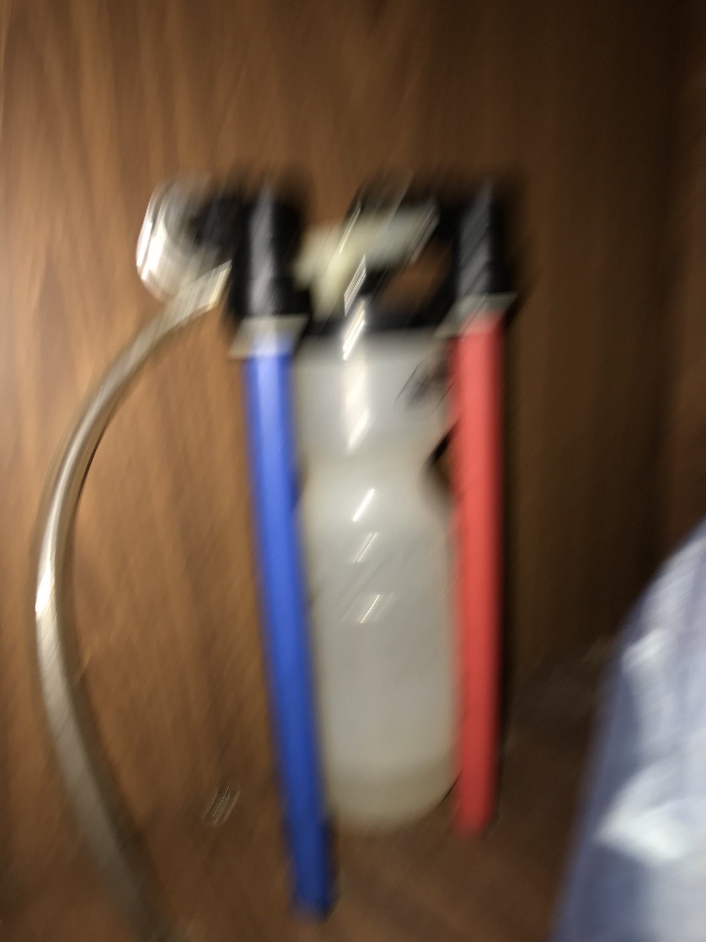

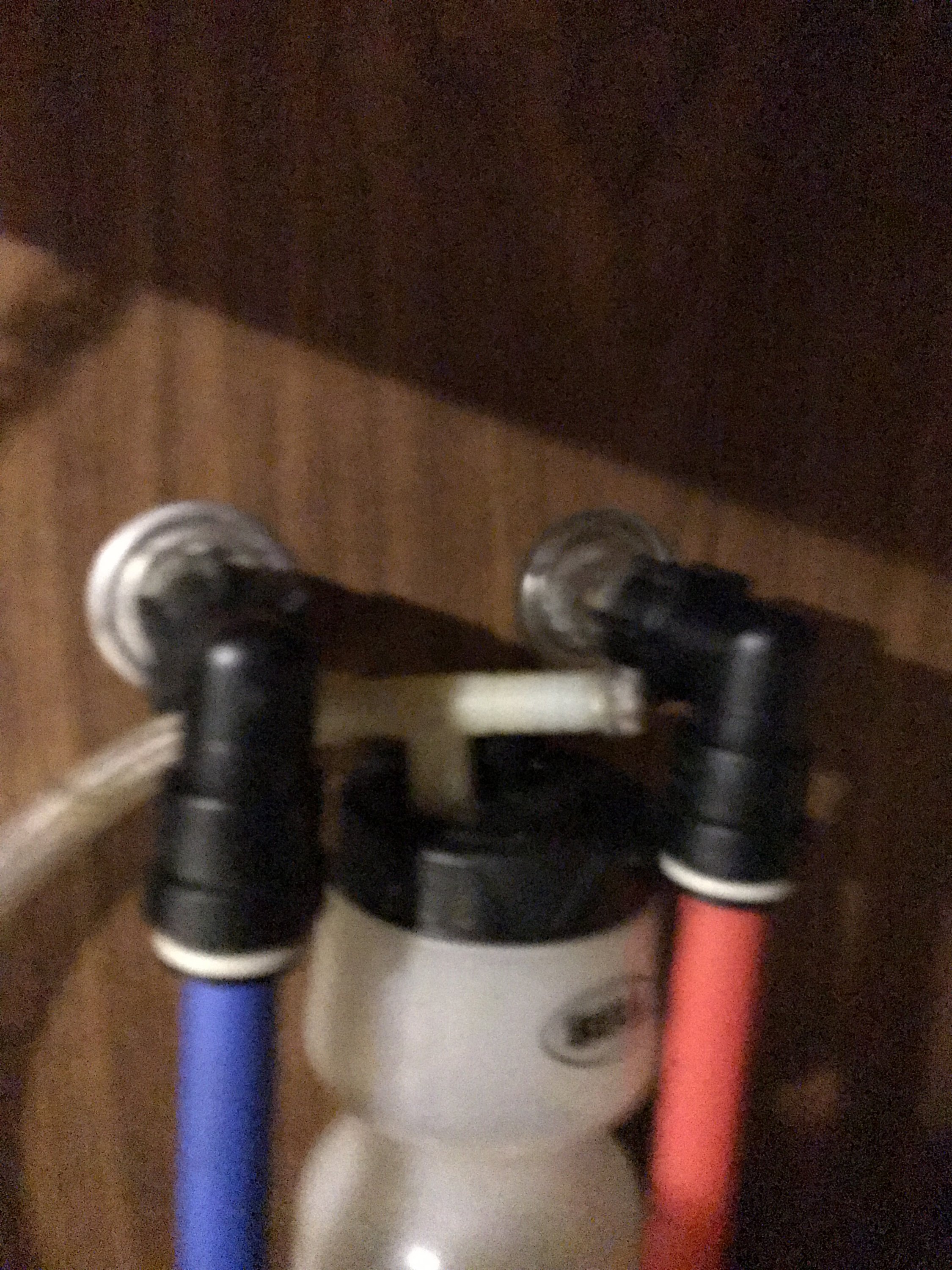

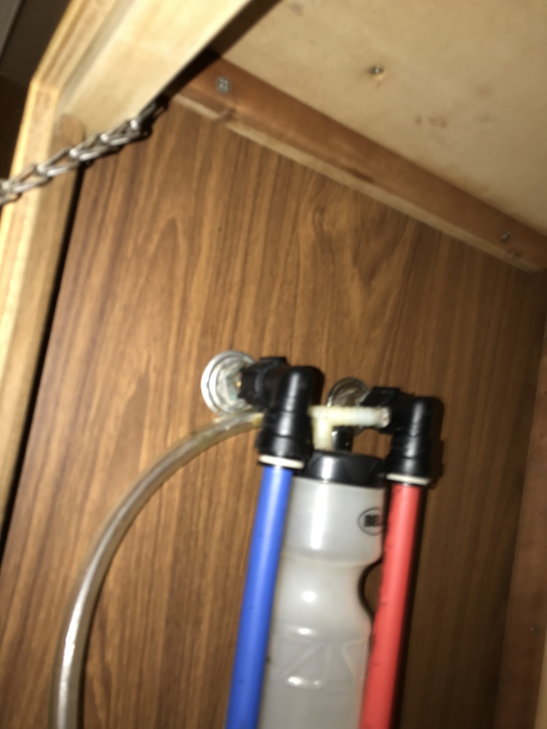

I have the vent hose as high as possible in the cabinet above engine and the hose goes into a water bottle and very little water but some times and just check once in a while and empty it.
