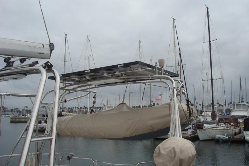

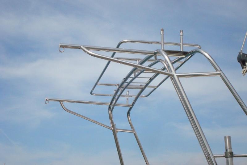

RyLaCade,
I am sorry that this took so long, but here are a few pictures of the Arch & Davits I had made for our 2006 Hunter 45 CC. On top I have mounted 3 - Kyocera 135 Watt Solar Panels, and threaded mounts for all future antennas. Email me if you have any questions, or if you want to see the boat.
Jeff
