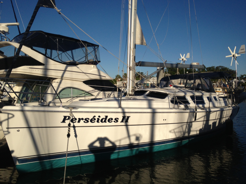

I have only had my 2003 44 DS for five months and I love it. They chain plates on the side are easily accessible not sure about the front one. As my yacht is one thousand kilometres away from my home at the moment I am still learning and discovering things. In six weeks time I will be having my longest trip on it yet, Down from Moreton Bay to Lake Macquarie where it will be based. Besides day sailing around Morten bay our trip from Bundaberg down to Moreton Bay has been our biggest trip so far, 4 leisurely days. I find the boat a dream to sail.
