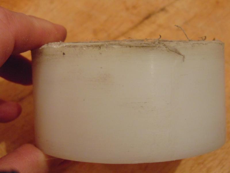

Has anyone replaced the upper rudder bearing on a Hunter 430. I am replacing mine and trying to find the proper height. The one that I removed is not the original has it has been cut with a handsaw and is uneven therefore the quadrant is rubbing on the housing and the rudder is moving up and down. Try to find info on previous post but no luck. Spoke with Tides Marine and they don't have any info on this model. I have attach a pic.
Any help would be appreciate.

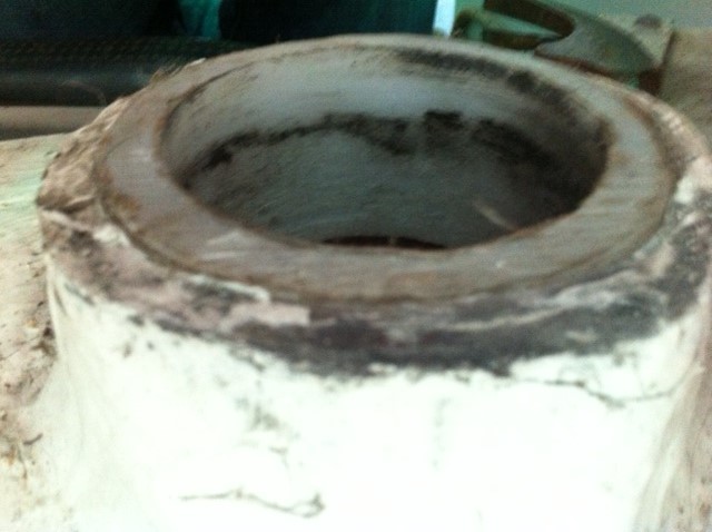

Naviculas this pic may clarified. The bearing under the steering quadrant in the housing of the boat that keep the rudder shaft from moving. Have you ever change it?
Thanks
