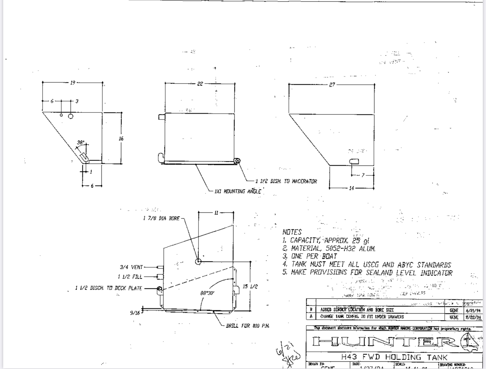

Looking for the technical drawing for the forward holding tank on a 1995 H430. The original tank on our new to us is very near the end of it's life and I'm looking to replace it. I've left messages at Marlow-Hunter, sent e-mails to the warranty section where they promise to respond and have yet to hear from them. Any one have the drawing available so I can have one constructed? I have posted the drawing for the port / aft tank if any one needs it.

even if you get the drawing....how do you plan on getting it into the boat???...I hardly think it would fit through the door??

Yes it has corrosion pin holes so were not using it at this time. I need the drawing to see if I can make it fit into the forward cabin, otherwise I'll need to design a different system. The aft tank is still usable but near the end of it's life span, Triple M plastics had the drawing for that one and it should just drop into place once the old one is removed. Were also changing the heads to a fresh water flush and replacing all the hoses and macerator pumps.

Thank you to Lawerence at Speciality Yachts in Vancouver BC, the Marlow-Hunter dealer for Washington state they were able to contact the factory to get a copy of the tech drawing for forward tank, Triple M plastics is constructing a new tanks as I write this. Expect it to arrive soon, then we will find out how hard it is to replace. Had to cut some of the floor support to get the old Aft tank out and the new one in. Will post some pics when it's all said and done.
attached is the drawing for the forward tank.

Although it is a PITA, it can fit through you companion way and forward passage. That is one of the Hunter's features and good design, that so far everything I have found on my 430 is accessible.

Triple M made the new tanks out of the polyethylene material to the exact drawings supplied by Hunter. Thanks again to Lawerence at Speciality Yachts in Vancouver BC for suppling the drawing and to Triple M Plastics for the excellent work.
