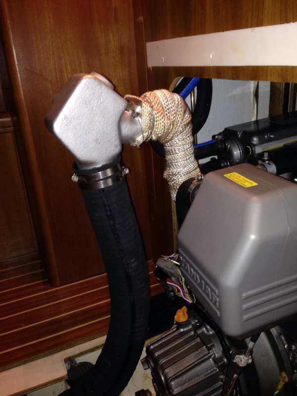

I bought a 2007 41DS a couple of months ago. Engine was replaced last year because of the issue you report. New exhaust with high elbow was installed this time. I read somewhere in the manual that came with the boat that this was an option when new. Sounds like this may very well have been a design flaw and what they considered an option should have been standard equipment.
Do you have a picture of the new elbow installation?

Hunter 41DS Herrington Harbour South
No pic with me. Will take one this weekend and I'll post it.

View attachment hunter08_41.pdf
Ray,
I have attached an options list for the 41DS from 2008. There is no option for a "high" riser on the exhaust. I think what is critical is the height of the exhaust hose, not the height of the exhaust elbow. On my boat the exhaust hose is carefully routed as high as possible under the starboard aft compartment, behind the the aft cabin. The seawater that is injected at the exhaust elbow only has to fall to the waterlift muffler when the engine is shut down, as it is under pressure when the engine is running. As the picture shown in this thread shows, the elbow is as high as possible as it has to fit under the aft cabin vanity. After the waterlift muffler, the water flows under pressure to the top of the exhaust loop and then falls out the thru hull.
I have had my boat 5 years and have had no issues with the engine. Also I have closely examined the whole exhaust system on my boat and have found no shortcuts or poor design. By the way, I would purchase my boat again and am proud to own it.
10,117
The crucial part is that the water lift muffler has to have enough volume to contain the water coming down the aft exhaust hose high loop after engine shutdown. It helps to have a high vented loop in the water line from the heat exchanger to the elbow.
http://www.westmarine.com/WestAdvisor/Exhaust-System-Basics
EDIT: oh yeah...and the elbow can't have holes corroded through the "uphill" side of its internal water jacket
