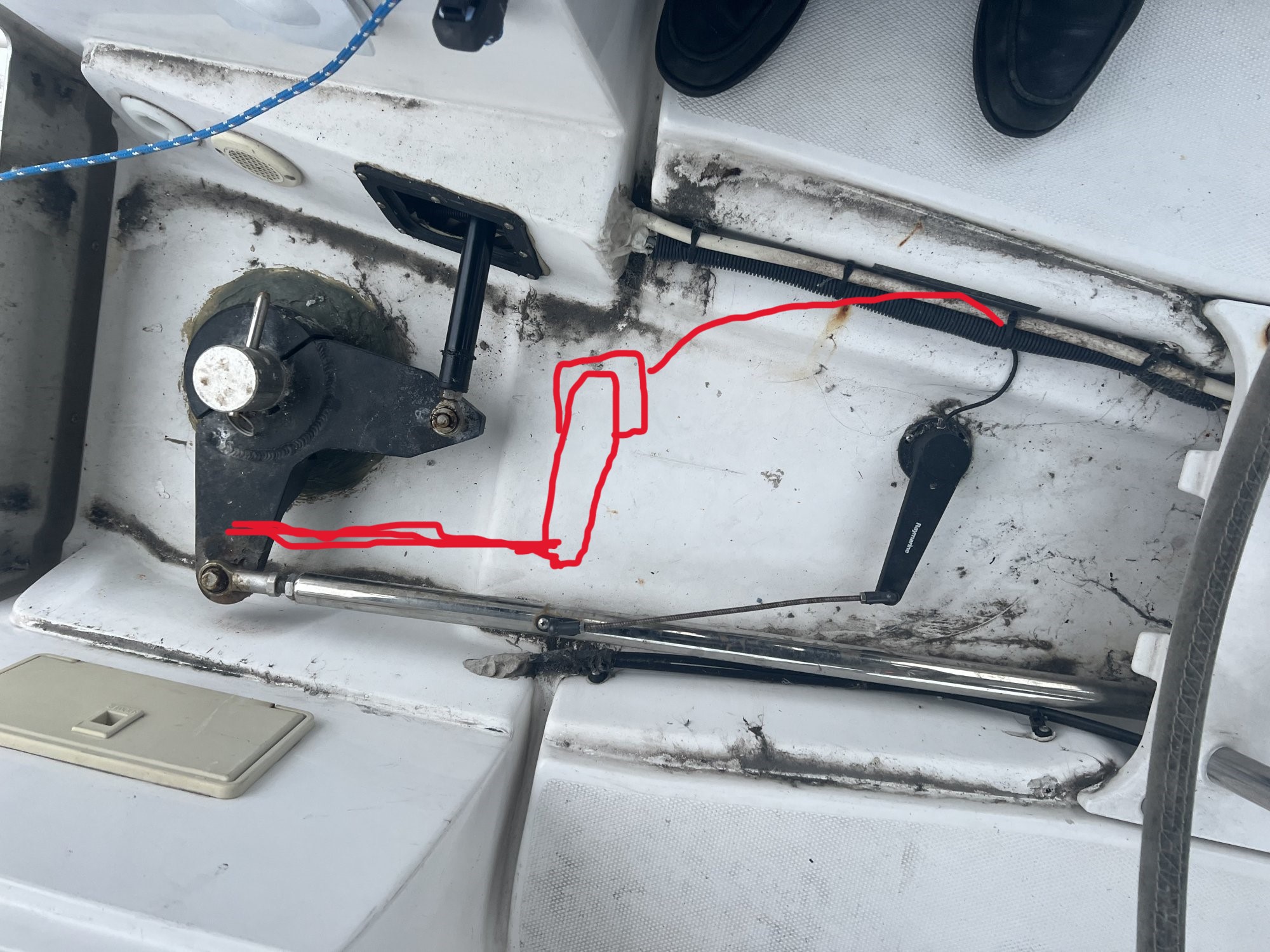

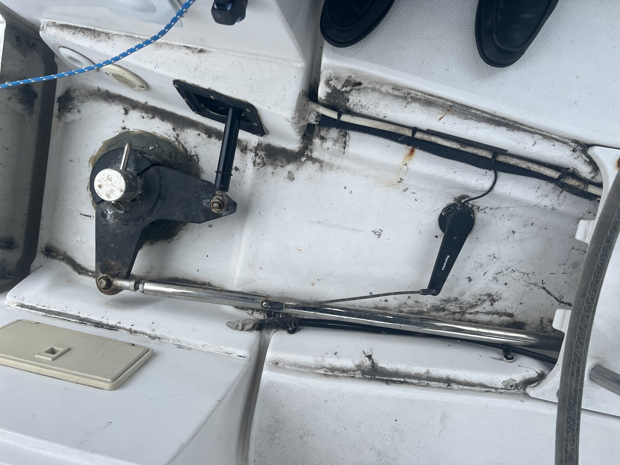

Q2: I noticed again two vents/hose areas underneath what I call the little 'clamshell' fiberglass section that is from the binnacle back to the swim step. From eyeballing below, with flashlight, mirror on a stick with a light, it was not totally clear to me where those hoses ran. Other than it appeared that they BOTH ran to the cockpit manual bilge pump.

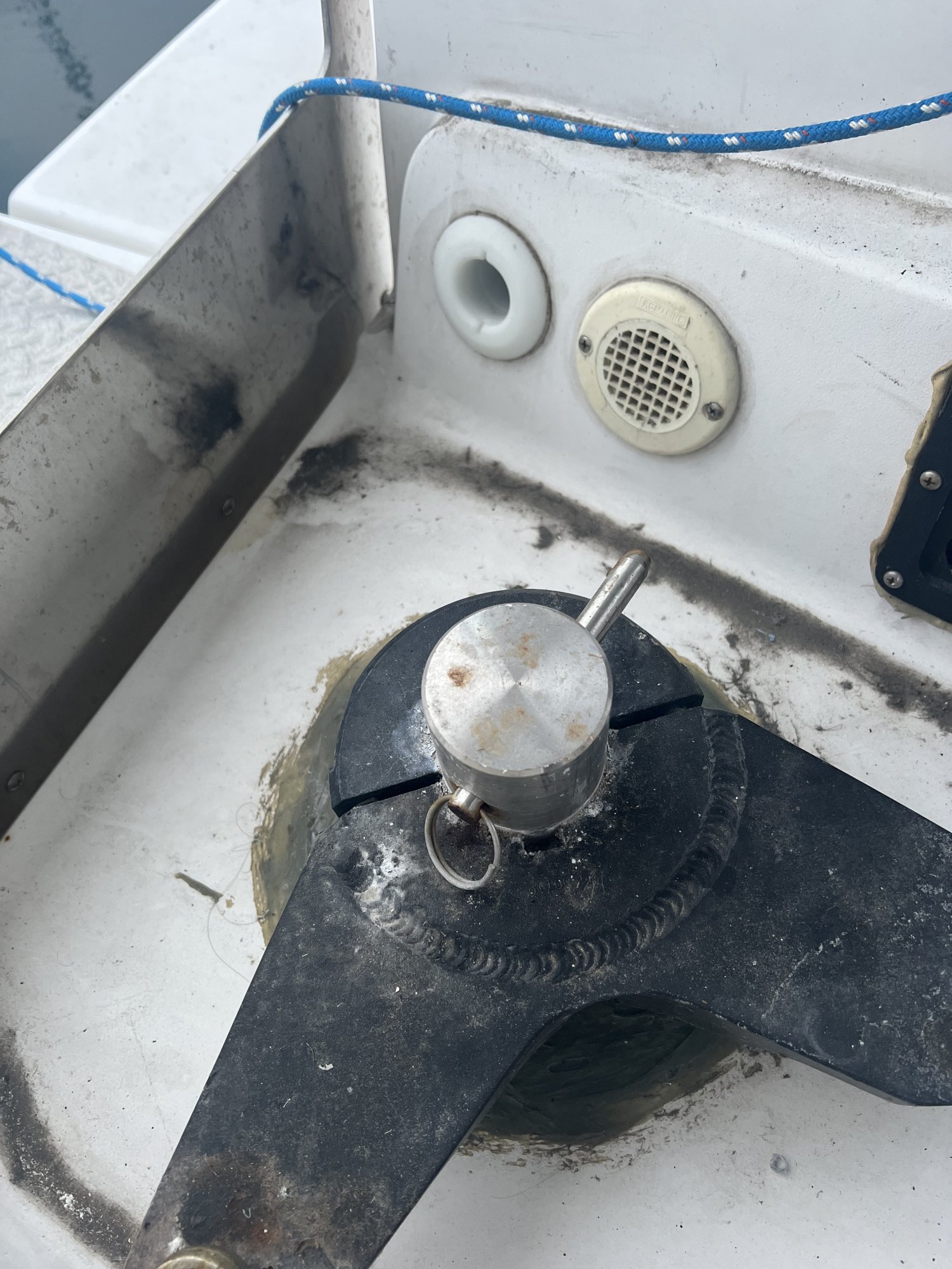

Edit - Adding some pics and and more question #3

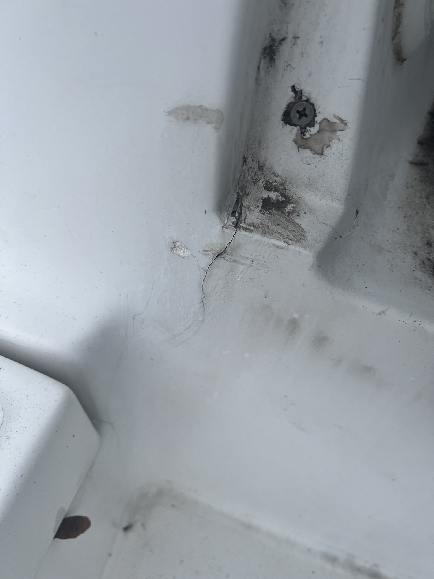

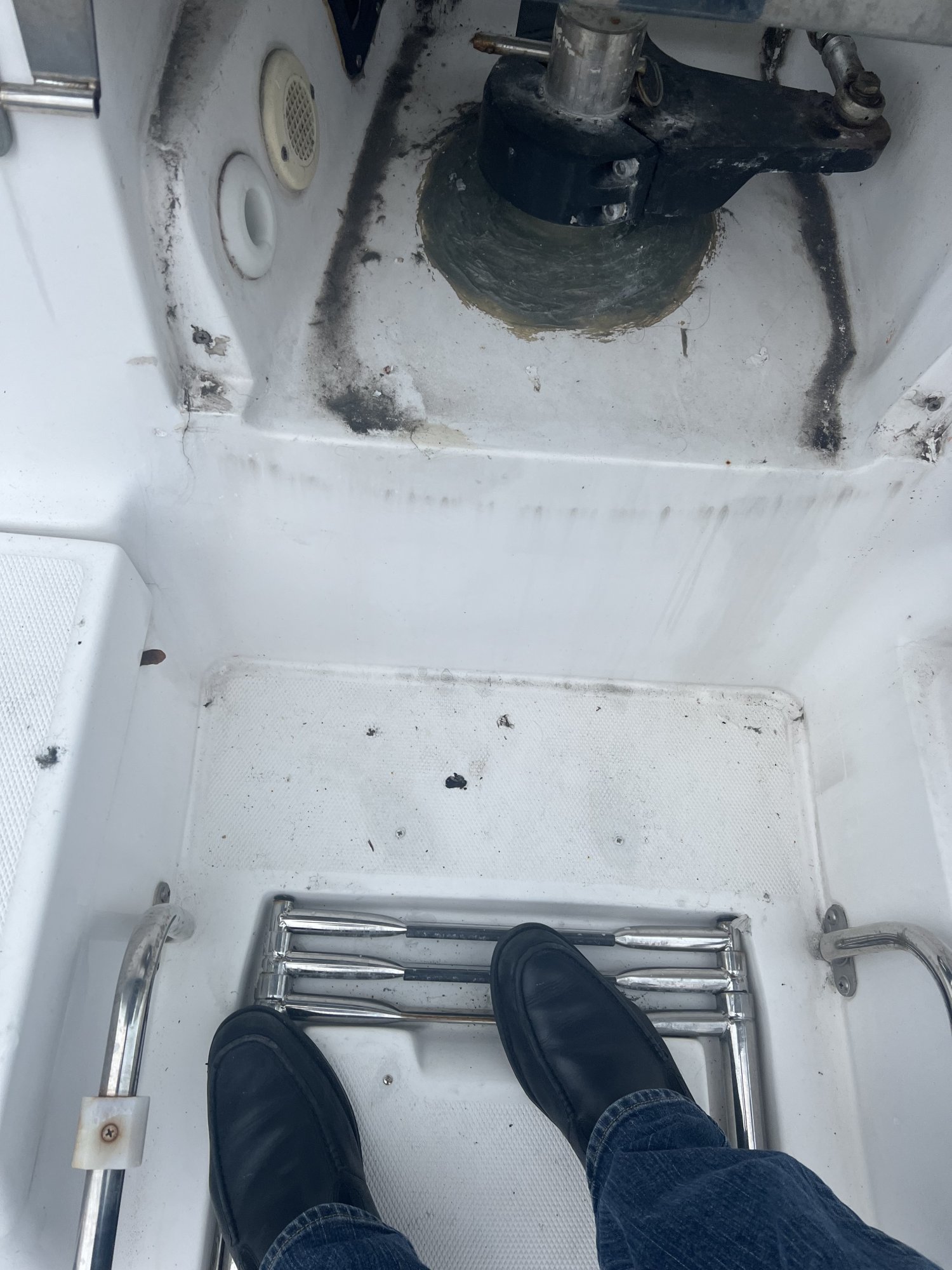

Q3: The aft end of the little 'clam shell' fiberglass place around the helm area seems to have weak supports, at least on my boat. I am going to investigate how far through the gelcoat cracks go and also it seems it would have been more sensible for original build to simply put in neoprene gaskets to spread the load across the entire weight/edge area?
