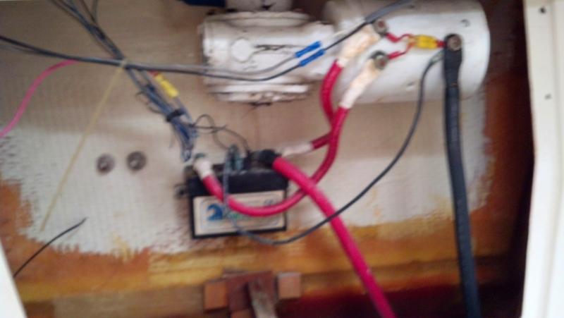

Hi,
I have a 1998 Hunter 410 with a Lewmar windlass. While working on the boat this past weekend I deployed all 250' of chain with no issues. While retrieving the chain the next day the windlass worked fine for about 200' then is slowed down to a minimal spin, useless until it stopped.
I was manually feeding the chain so there was minimal strain on the windlass as the chain was just dropped onto my dock.
I have an up and down foot button, a Lewmar windlass, and a So-Pac Windlass Control box (relay) model SPA-10700 which takes the foot button signal and sends DC power to the forward or reverse terminals of the windlass motor.
When I tested the DC power at the relay it was about 12 volts. When I pressed the foot button the power at the motor was only about 1-2 volts and decreased rapidly.
I am assuming the Windlass Control relay is shot. But, I don't want to buy a new one to try it because they're not cheap, $140+. I don't have jumpers large enough to jump out the power around the relay, I guess I could use my car jumper cables, so I am asking this forum if this sounds like the culprit. I am REALLY hoping it's not the motor, but don't think it is because it's not getting power when IO press the button. It does get some power for a short time and I here the relay clicking when I press the button, so I also don't think it's the buttons.
I have a picture of the relay attached and the windlass motor in case that helps.
Thanks as always!

Maybe from what I can see is maybe some corrosion around the wire connections at some time.
I would be very careful and clean the connections on the relay and careful not to break them and maybe spray electric spray cleaner first and maybe new connections from small wires and also clean up the large cables.

Hmm, so I know that neither the motor nor the relay control were hot. But, touching is not always accurate since it could be the backside or the unreachable side of wither that could have been hot. But, I don't think that was the issue since we took a long time to retract the chain, My Dad fed the chain off the dock, I pulled it to the front of the boat over some rope guides, and then the windlass pulled it up straight, and on and on taking several long breaks. Having said that, I don't see anything like this in any of the pictures but I'll look again.

BUT, I'm sure all that corrosion is not good so it does call for cleaning and protecting.

Thanks Bill, I do understand the concept of voltage drop, 4 years of EE school and several years in the field as an engineer. Also, noted is the issue of corrosion but the picture shows it worse than it really was and as I stated the relay did kick in when I pressed the button and the motor did turn albeit slowly, so the most corded parts, the button terminals, were not the issue. The battery terminals are fairly clean and tight, but do warrant some cleaning. Also, I am pretty sure the voltage drop across the batteries, at the batteries, would occur if the motor was the culprit as it would draw down the battery voltage as it bogged down. In my case, the batter voltage did not waiver at all which leads me to believe the relay was acting as the blockage and not even letting any power through it.
I'll be on the boat on Tuesday/Wednesday this week and will report back more findings. I'll also have my car jumper cables with me to bypass the relay and I'll try that before I clean all the terminals.

If you measure the voltage again be sure to tell us the voltage at the small wires on the terminal (the control circuit from the house main DC panel) and the voltage on the large cables (the windlass motor circuit from the start battery). If low on the small wires it probably is a corrosion problem at the connections (you really need to clean those based on your photos), if low on the large cables it is your start battery.
