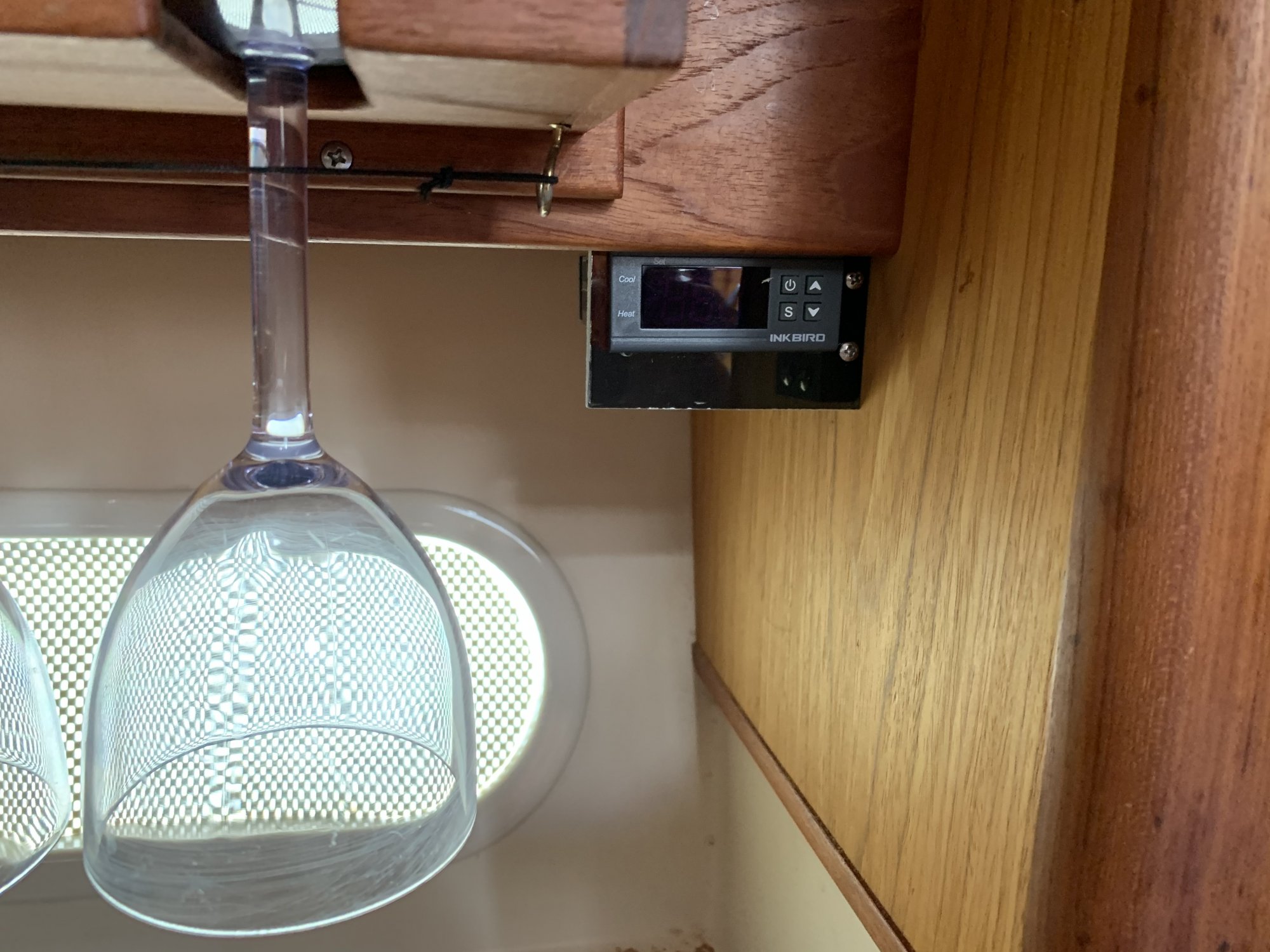

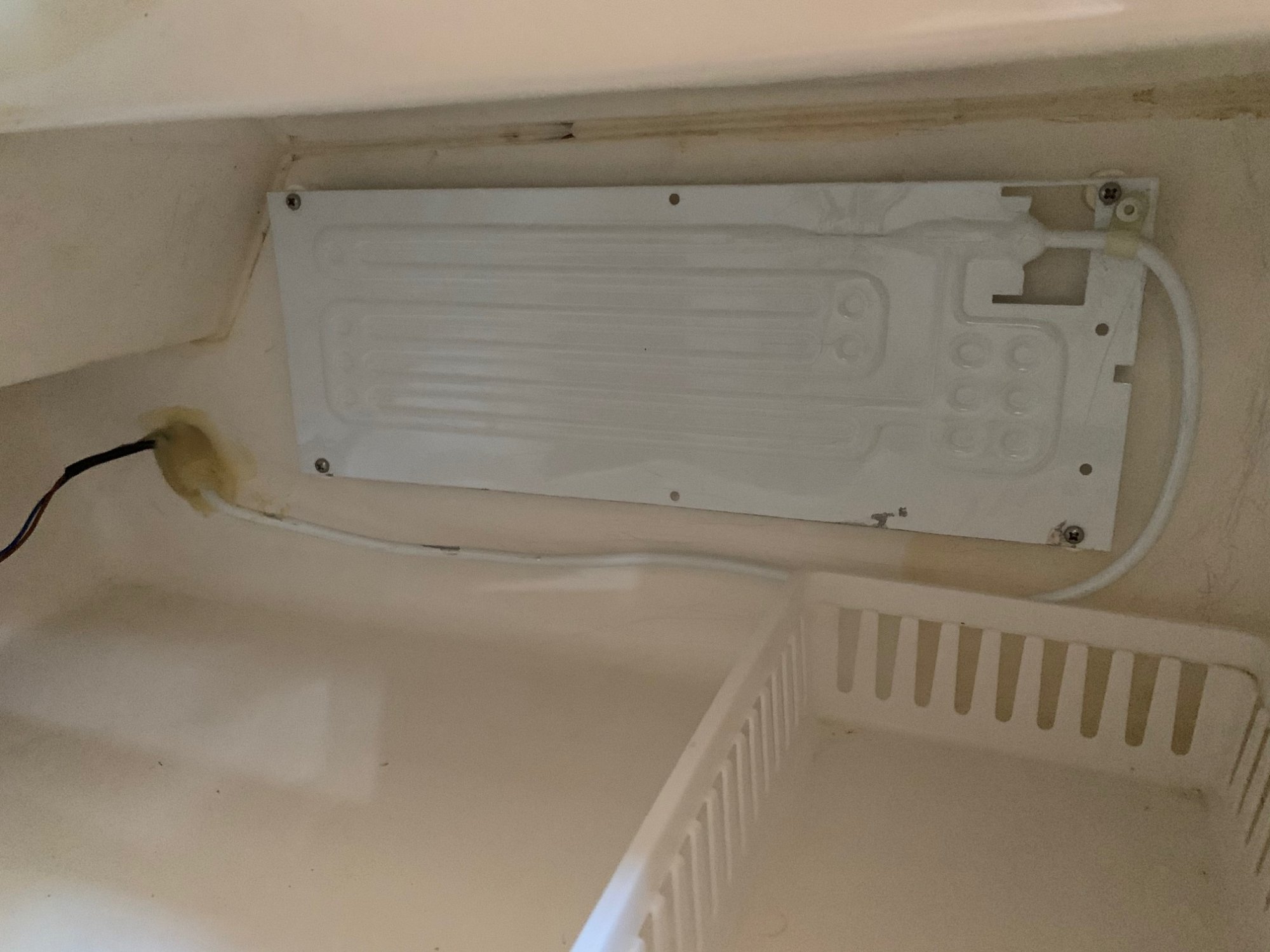

Three pics attached. Copy of purchase order, pic of the coil and pic of recently installed electronic t stat. Unit is under stove so don't have a pic of that. I also installed a pan under the unit for condensate. Don't need a drain as it evaporates. Bought from Defender.

So what is the size of of that evaporator? Doing the math the frig volume indicates a pretty big unit. What temp is it maintaining?

It freezes the beer! When you consider the freezer next to the frig is below freezing the frig unit can be smaller than calculated. Boat in yard today so can't go out and measure it.

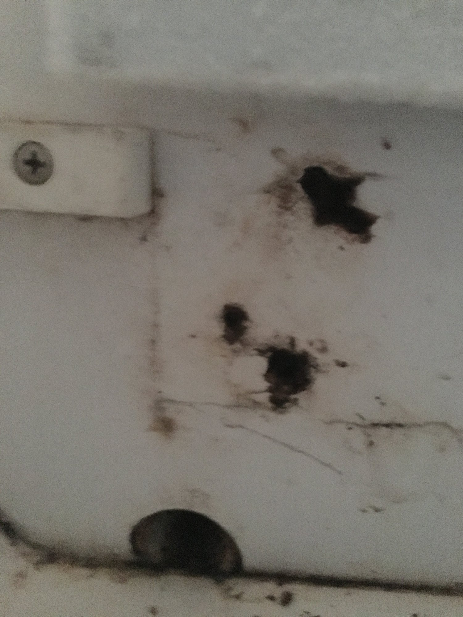

I have a Hunter 410 2001 model with the split freezer/refrigerator. The wall between the refrigerator/freezer boxes is rotted above the drain hole where the freezer door hydraulic lift arm attaches to the bracket and starboard offset. The cold plate is just above the rotted area. The wall no longer has enough meat to screw the starboard block offset into the wall. Has anyone heard of this problem and have a suggestion for repair?

I have a 99 410, same problem, somewhere down the road I'll need to rip it out to rebuild.
What I did in the meantime is get stainless sheet metal, made as large as possible plate for both sides drilled holes in it of course and used good adhesive and 4 little screws in the corners of the plates on both sides. I tied both gas shock brackets together with the same through bolts, very strong, been like this for years now.
