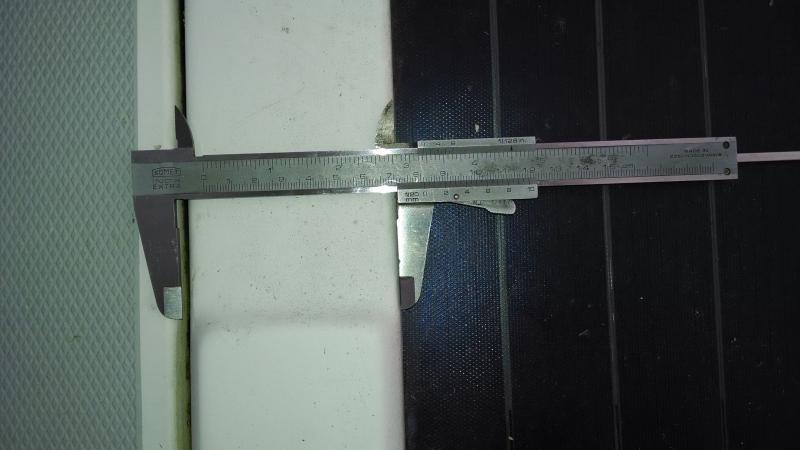

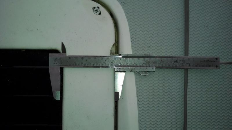

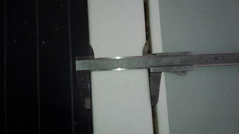

Solar panel
Just got back from boat and measured solar panel trim line;
at the conector box is 3 3/16" evryvere else is 2 7/8" wide and panel is 5/8" deep.

I am confused with your bezel question. Why you need that? When you remove solar panel (18.87x23.25 with corner radius 2.25") this is your opening in the deck you need make same size replacement 5/8' thick and btw it is white. I am just thinking maybe you will remove just solar panel and keep bezel??? OK ,but water will stay there as is now.
I didn't do it yet, it so cold ...but I am replacing whole thing 18.87x23.25 with King starboard 3/8" and underlayment of 1/4" FRB board.
Measurment with caliper looks off but that is because lens is square only with reading side. Measurments are exact what you read on caliper.
Pictures are from left to right; port side, starboard and stern
