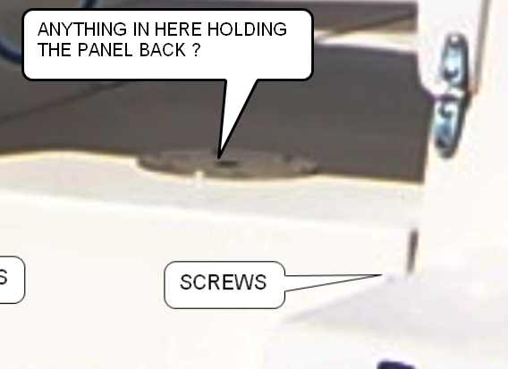

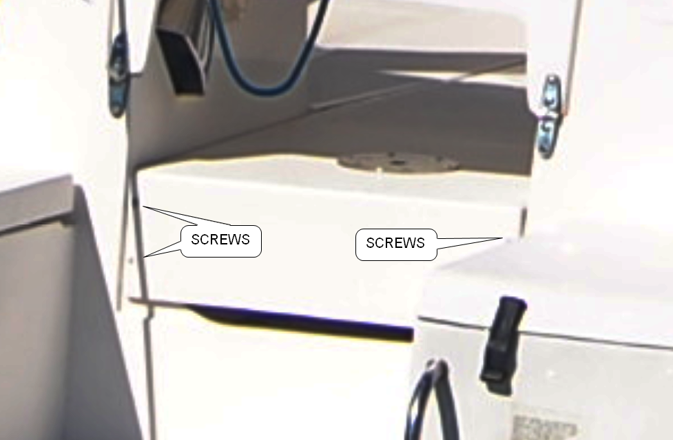

Sounds like the same layout as the H-310. There are four screws at the aft face of the floor panel which you may have missed.

Thanks for the reply, and for the picture. Yes, we found those 4 screws are removed them. There's still something interfering with sliding that panel back toward the stern. I"m wondering if the stern shower trim is the culprit? And it feel like the panel doesn't want to come straight back--it needs to lift as it is moved back, right?
Any chance you could take a picture of the bottom of that panel, and the space it comes from. so I can see what holds it in pace?

It should just slide out. The first time I pulled mine there was some calking attached to it from when the boat was built. There is no tabbing. you cannot lift it up or the shower box will stop it.
Jan 4, 2006
7,303
It's lifted maybe an inch but as @ice breaker says, there's no tabbing holding it back.
Nothing there to hold it in place. If I ever forgot the screws, the panel would slowly work it's way back until I was in the drink while on the helm. The underside of the panel is flat.
Maybe remove the cover which leads to the temporary for the rudder. Maybe there's something in there holding it back.
Question for you : can you lift the panel up an inch or two with the screws removed ?
