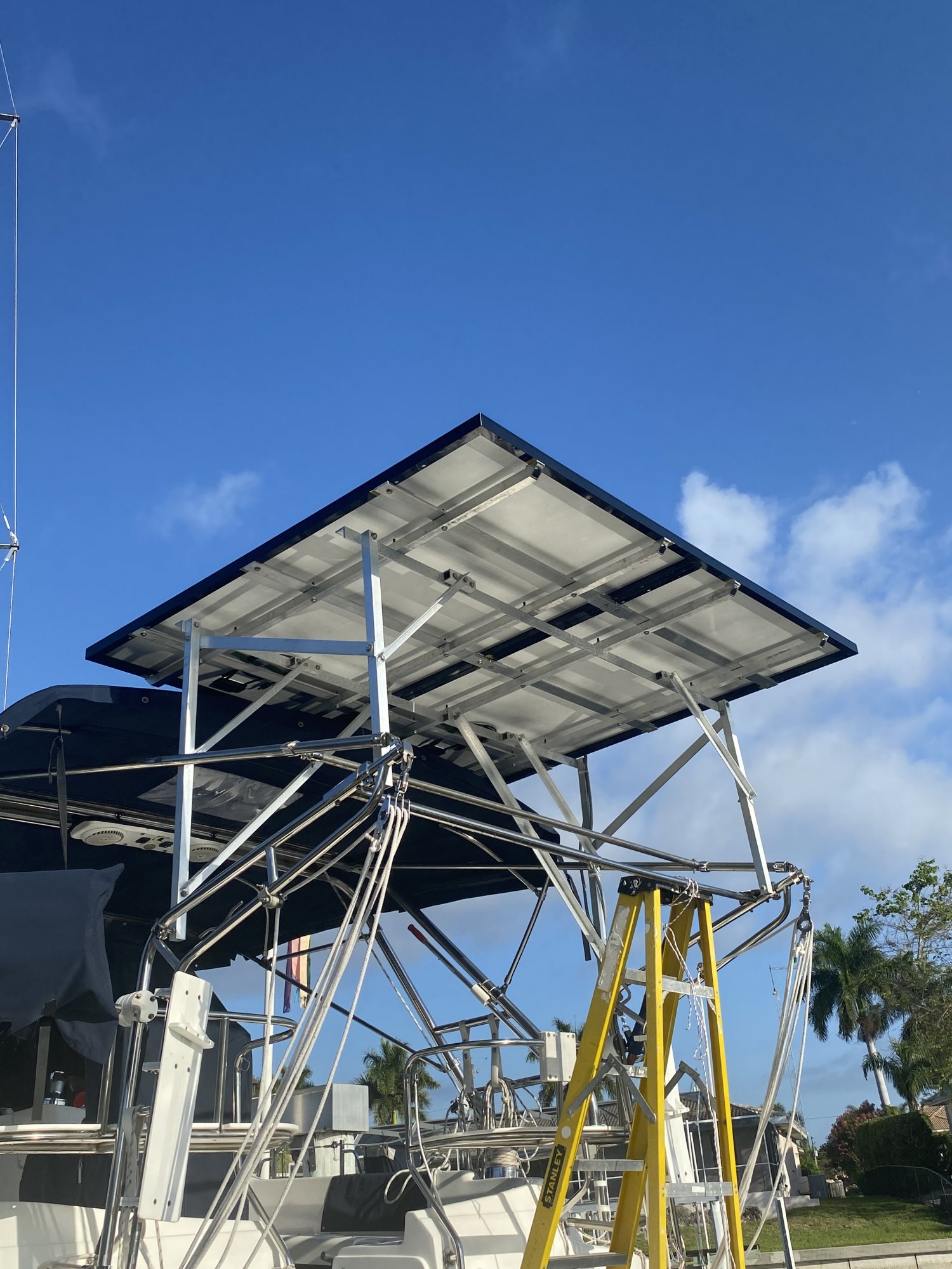

I think this reply has been the best one I’ve gotten here thus far. Do you happen to have any photos of your solar setup you could share with me? Also, where did you put six GC’s? They couldn’t possibly have all fit under the nav desk seat.
The batteries are Trojan T105 Deep Cycle Golf Cart Batteries. Half the size of a 4D. Four (4) will fit under the nav station seat in the battery compartment and two (2) more will fit under the sole plate where the start battery is. Solar Panels are LG 395w (2). My Solar Controller is a Victron 150/60. I use a Xantrex Linkpro to monitor the whole system. I have attached a couple of pictures and a wiring diagram for my system!
