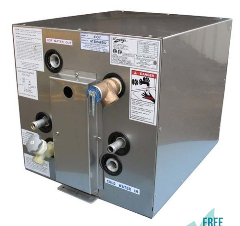

Here is an image of the Kuuma 11841 water heater that my 41DS has.
The two unlabeled nipples sticking out just below the horizontal centerline are the heat exchanger connections.
