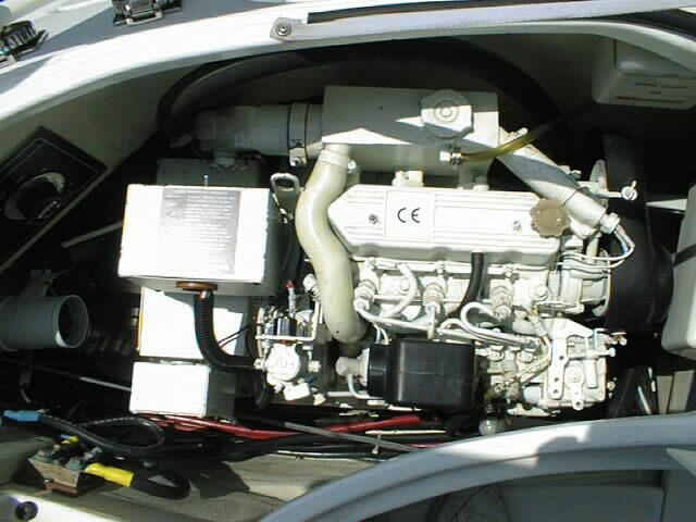

Hi Smokey, I have a 1993 40.5 and I have a Phasor 6KW generator installed in the port aft locker. It will power anything you want and is worth it's weight in gold. Now that I have had a boat with a generator I will never be without one. Only draw back is the noise in the aft cabin but if you are using the generator while on the hook we always run the A/C until bed time and then cut it all off with the boat closed up and with a fan the boat stays cool all night. The phasor 6kw will burn about .3 gal/hr so having one is a no brainer. If I can answer any more questions get back to me and we will talk.

Thanks Mike, Looks like a clean setup.
What did you do with your CNG tank or have you converted to Propane and have the tanks somewhere else?

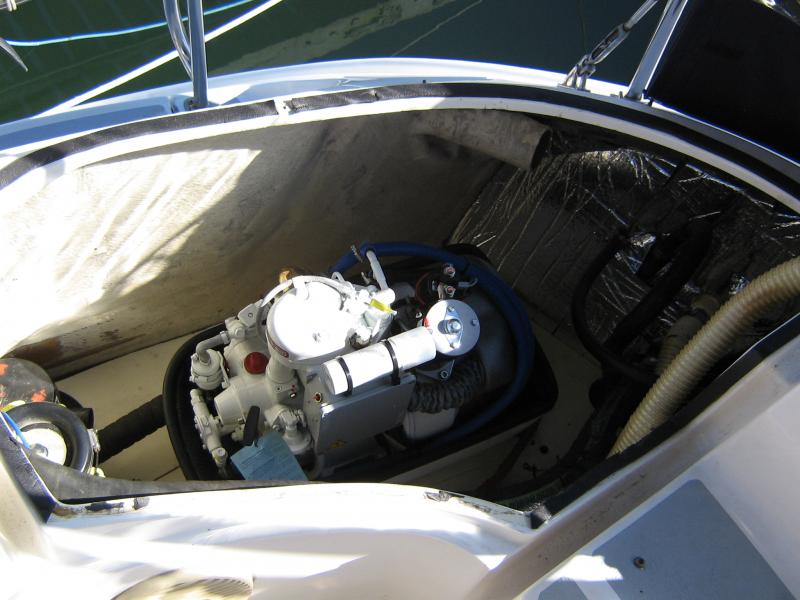

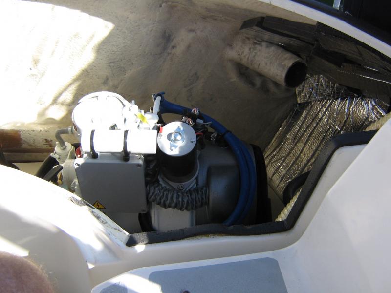

Dan we have a '95 40.5. It had a Fisher Pander 4 Kva when we bought her, but this was already past it's use by date. We replaced it this year after a lot of research with a Paguro 4000 (the Fisher came in a close second as both brands are based on a Ferryman diesel) The Paguro has an Italian generator where the Fisher is all German. Naturally the Paguro looks better.;)
This unit runs our 16 BTU air con et all.
It is situated in the port stern locker. We have 600 ah of batteries in the starboard locker to balance this. Our gas bottles are in the port lazarett.
I put in sound reduction foam but in hind sight I would put in the water separation system of exhaust as well.
I did all the work with good clear instructions, except for the actual connection of the 110 v. This had to be done by a licence electrician to get certification.
Photos are with the sound casing off.
Good luck.
