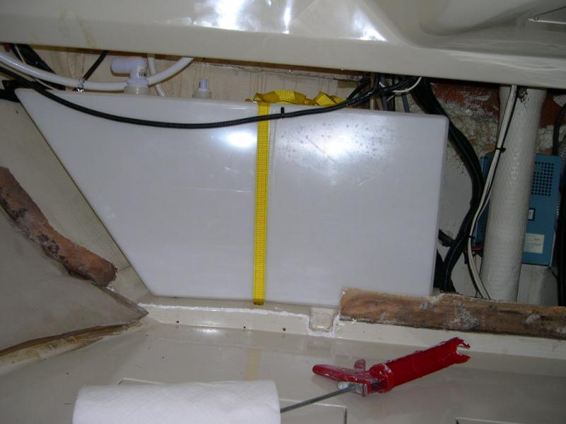

Mine came strapped down thru the floor. See picture I used a nylon strap for the new tank. I also drilled a drain hole on the surface of the floor where is lower than the rest ( right of the strap hole).
Replaced the kick board with Marine teak faced Plywood.
