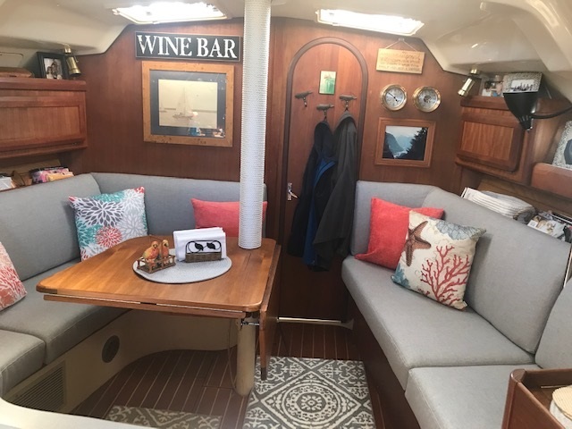

Looks terrific. I have seen some that were not so much...!

One of the things I ran into with the 40.5 table was that you had to seriously crank on the mounting compression handle, or the table would spin if someone knocked into it.
I drilled a 1/4” hole through the clamp and the compression post, and stuck a stainless ball detent pin into it. (The kind with a plastic handle on them)
You’ll need to make a mark on the compression post to ensure you lift to the correct height, if you decide to drop the table for a bed

Dang, Art; that's a smart fix. Our table is a custom one that cost the PO a ton. he sold the boat to us in 1999 and we are the ones who got to enjoy it. I'm going to employ your fix.
