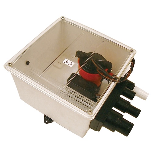

Hey Guys,
I'm down to our last system to get functioning...the sump pump. I cleaned it out yesterday...yuck...I don't think it was ever done. It looks very similar to this picture. It was full to the top with water etc. So either the float switch is bad, or it's not turned on. My manual states there is a switch by the vanity which I don't see. There could be a breaker for it, if so, it's probably labeled wrong. Before I did in to debug, any ideas?Sump Pump.jpg
Feb 21, 2013
4,638
Hunter 46 Point Richmond, CA
My Hunter 386 manual showed sump pump switch on the panel (6th witch from the top), same as I have on my Hunter 46 and you are correct the sump diagram on page 59A shows a switch in the vanity.
Sep 25, 2008
7,609
Alden 50 Sarasota, Florida
Check to see if you have 12 VDC at the pump and float switch. If you do that, you will know where the problem is rather than guessing.
