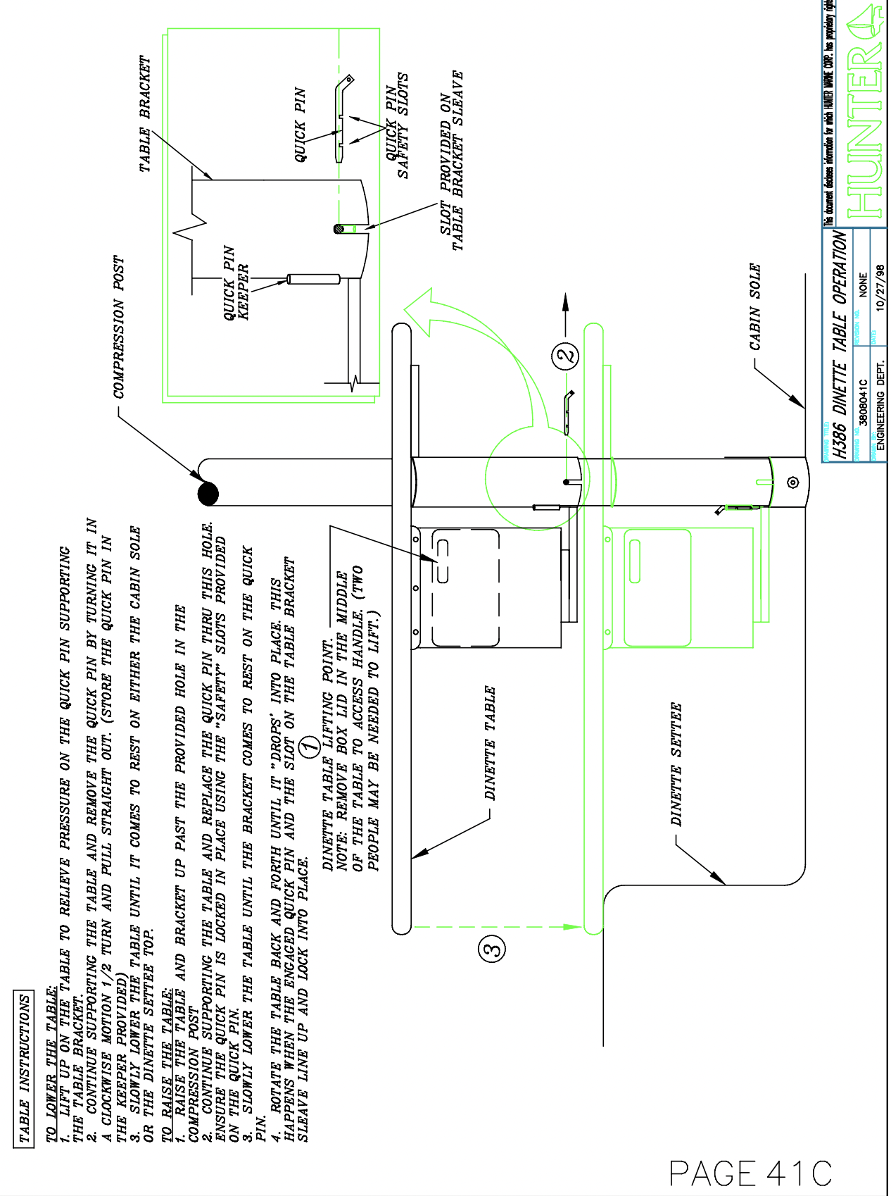

I recently purchased a 2002 Hunter 386. Can the salon table be converted into a bed. The table top looks like it can be dropped down but there is nothing in the owners manual that describes converting the table into a bed.

Quite the elaborate process when compared to my '99 H-310. From the date on the drawing :
..................... I see that both our boats are newer. Your 2002 model may have a counterweight within the compression post as does my 1999 model. If so, the release mechanism is under the table and the table moves with an assist from the counter weight. All you need next is the cushion with the cutout for the compression post and it's off the the land of nod.
Ralph, Hopefully my model has a counterweight within the compression post. Thanks for the additional info. Tom
