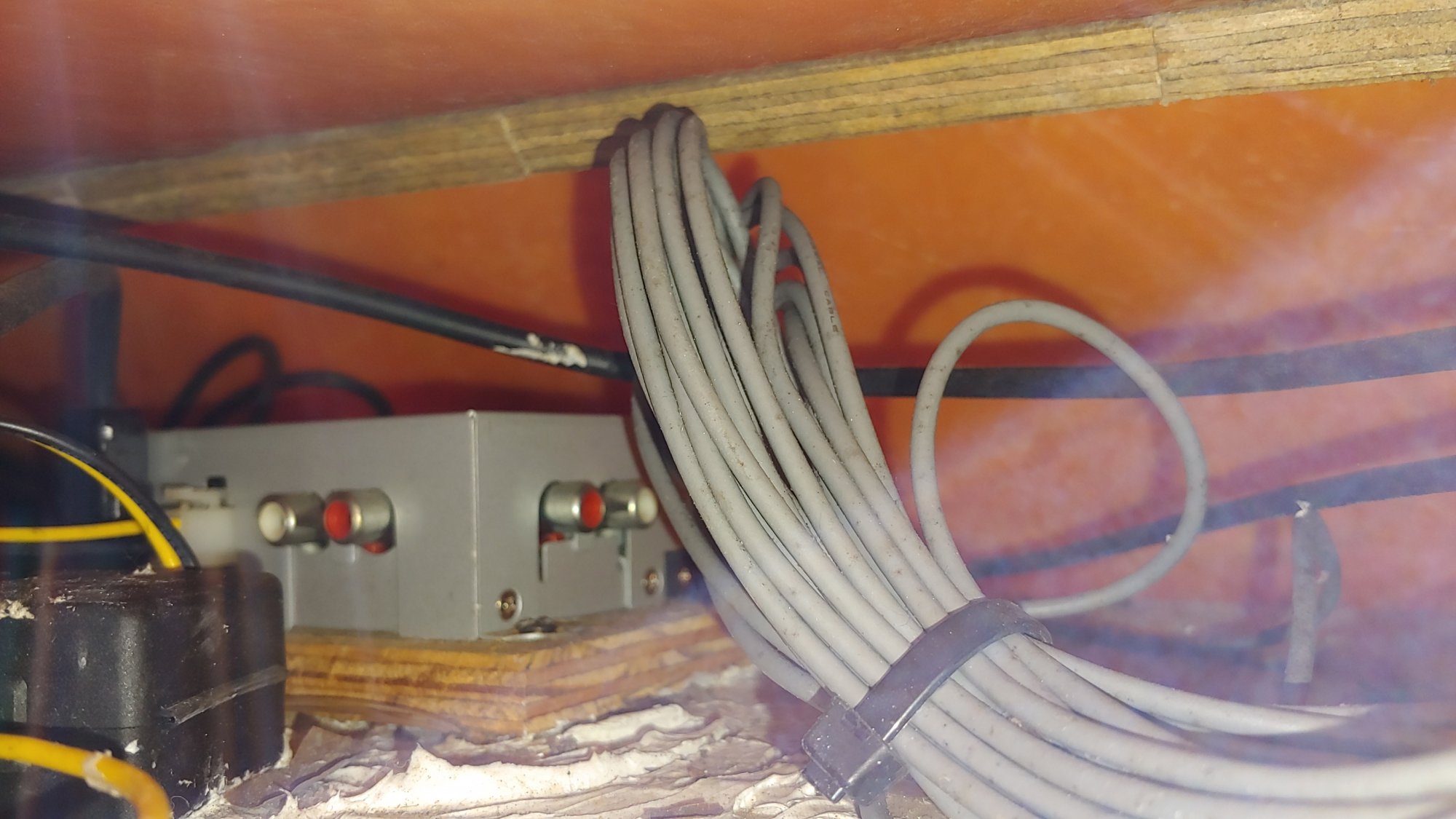

As I prepare to replace the cockpit stereo with a marine-grade Kenwood KMR-M328BT Marine Digital Media Receiver with Alexa and Built in Bluetooth I noticed under the cowling a separate electronics module, perhaps an amplifier, that is connected to the main (head) unit of the Sony stereo with a BUS cable. There are two visible sets of left/right (stereo) RCS jacks that are presumably additional speaker output jacks (possibly for a sub-woofer). See attached photo--looking in to cowling through cut-out for Sony unit. Unfortunately, without disassembling the entire cowling, I cannot remove the mystery box, nor see/read any markings. I can feel what is presumably a label on the top of the box but cannot get a camera in to take a snapshot of it. And I cannot remove it as the screws are not accessible and the plywood to which it is attached is glued down.

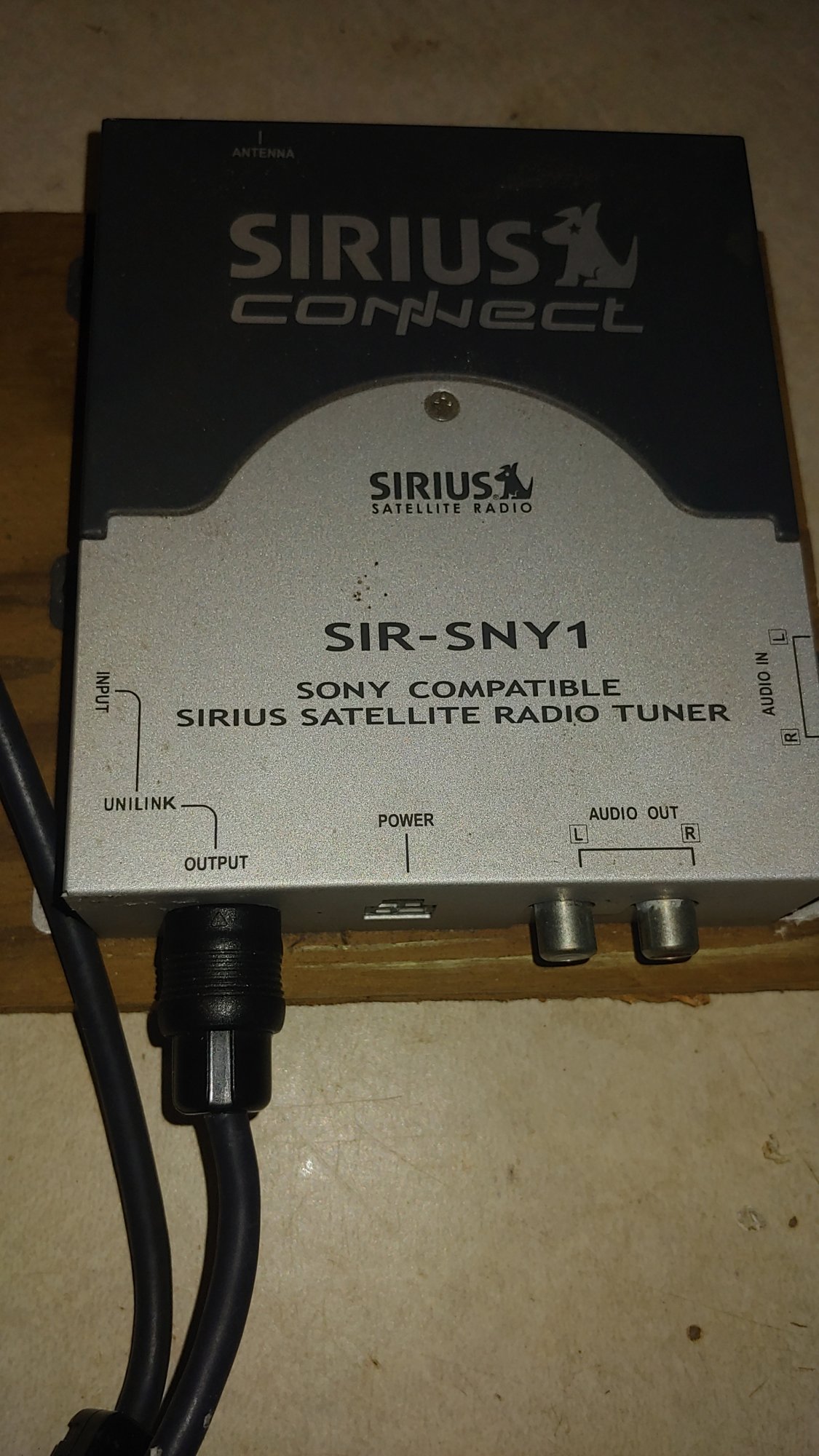

UPDATE (9 Jun 2022): Mystery box pried loose ... turns out to be a Sony-specific SIRIUS radio receiver (SIR-SNY1); photo attached. Aside from the power, only the output cable was connected to the Sony unit; no other connections.
