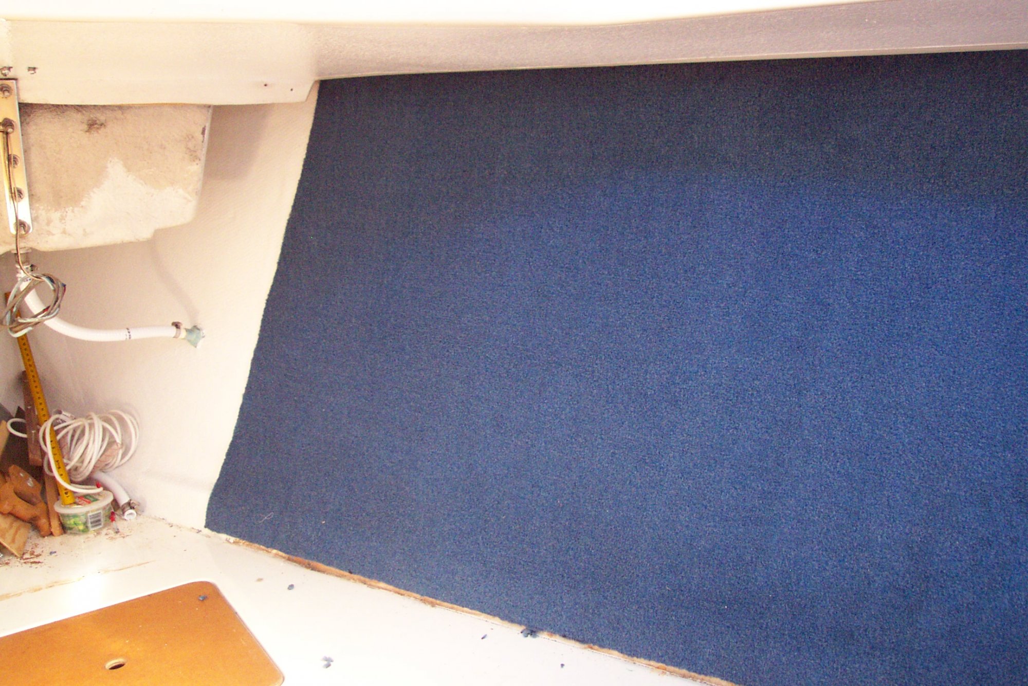

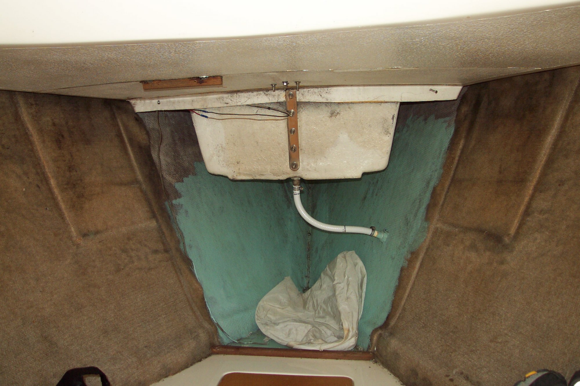

We had what other owners called "mouse fur" in the vee and quarter berths and all over the internal storage spaces. Ugly stuff that invited moisture problems. Removed it all back in 2002.
In the vee berth I replaced it with blue out door carpet and after 23 years am still happy with the result. In addition to the 5 years we lived aboard we have spent many hundreds of nights in there and making it comfortable was a priority.
The rest we just painted white. It looks good and really brightens up the various spaces, including the quarter berth. Other owners have done some beautiful projects lining the surfaces with paneling etc. but functional is my mantra. I have attached some before and after pictures.
