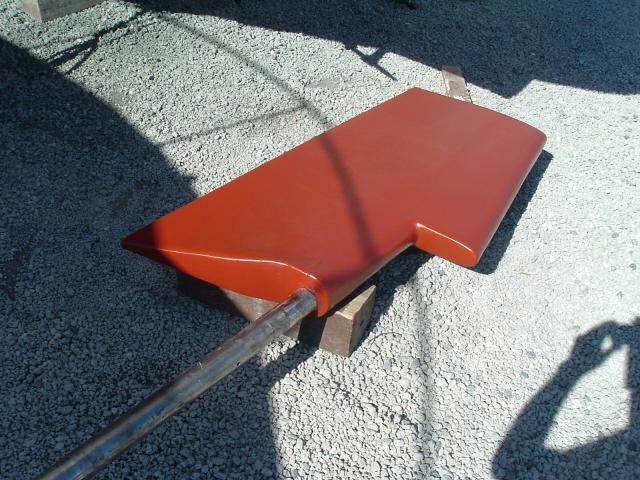

Water logged rudder from being wet so long. They nearly all get wet inside the foam core. Did you recover the piece? It can be rebuilt!

What is the material of the rudder stock and approx diameter? Solid or tubular?
I recall that when Hunters went over to FRP rudder stocks they built a rig to make comparative strength tests.
They reported they could break the stainless steel ones but whilst testing the FRP version the rig destroyed itself - so they concluded composite was better!

Really no value in recovering the rudder. Taking it apart to replace the rudder stock will cost at least as much as a new rudder. The stock is very heavy stainless tubing. It is hard to understand how one would shear off unless it hit something. Did you ever have a grounding or anything else that could have weakened it? You know how anal Blaise is about his boat. He lost his rudder last year on the way back from Mexico to St. Pete. I think in the same way. On the other hand I had my rudder rebuilt in 2008 using the same stainless, now 32 years old. Your story concerns me.

When my rudder failed it did so after hitting a large object as we slid down a wave. From the remains, it was clear that it was a lateral impact that fractured the tube on the impact side and then peeled a two inch strip of the tube up on the down impact side. In my case, there was no evidence of corrosion. It failed well above the top of the rudder blade. I have heard of H37 cutters losing their rudders but in almost all cases they were shoal draft boats that have been grounded and then had the rudder shaft straightened. I don't think that is a good idea unless you never plan to sail out of cell phone range. When I had Foss Foam (still the best choice for replacement rudders) build Midnight Sun's new rudder I had them put a solid steel insert in the rudder tube for the first foot into the rudder and extend up two feet into the hull. At the time, I thought I had come up with the perfect bullit proof rudder. As Ed says I am a little anal when it comes to ocean racing, and even though we sailed the boat back 240 miles to Florida without a rudder, it is not something I would like to repeat. Now I am wondering if I didn't eliminate a crucial frangible link, and instead set myself up to rip the whole stern out of the boat if we hit something else. I keep preaching to not screw with John C's design and need to listen to my own advice.

You took the words out of my mouth Blaise. I had written on other occasions about an idea to insert a second tight fitting stainless tube inside the rudder stock. The problem is, as you point out, the likelihood of tearing the stern out of the boat. Same idea with putting a big backing plate inside behind the strut. Would you rather have two one inch holes or a hole the size of the strut plate?
