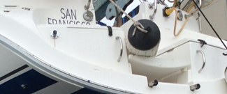

I have a Hunter 376 and I would like to install a water inlet regulator so I have constant water on the boat. Does any one have pictures of where they mounted there inlet? I am hoping to put it aft on the starboard side so I can connect it to the cold water on the transom shower.

Install on the same side as your transom shower. That is where mine is located as shown in the pic below. See plumbing layout on page 57 of your owner's manual Hunter_376_10424794.pdf (sailboatowners.com), which indicates the transom shower is located on the starboard side. Tee in the shore water hose into the transom cold water line, but I suspect you planned to do that.

Thank you for the quick response and the picture. Unfortunately my LP gas tanks are in the starboard locker. The locker is totally incased so there is not access. Is your picture of a 376

If you do not have room to route shore water hose through the starboard lazarette locker then suggest looking for a route through the port lazarett locker to tie into the transom shower cold water line.

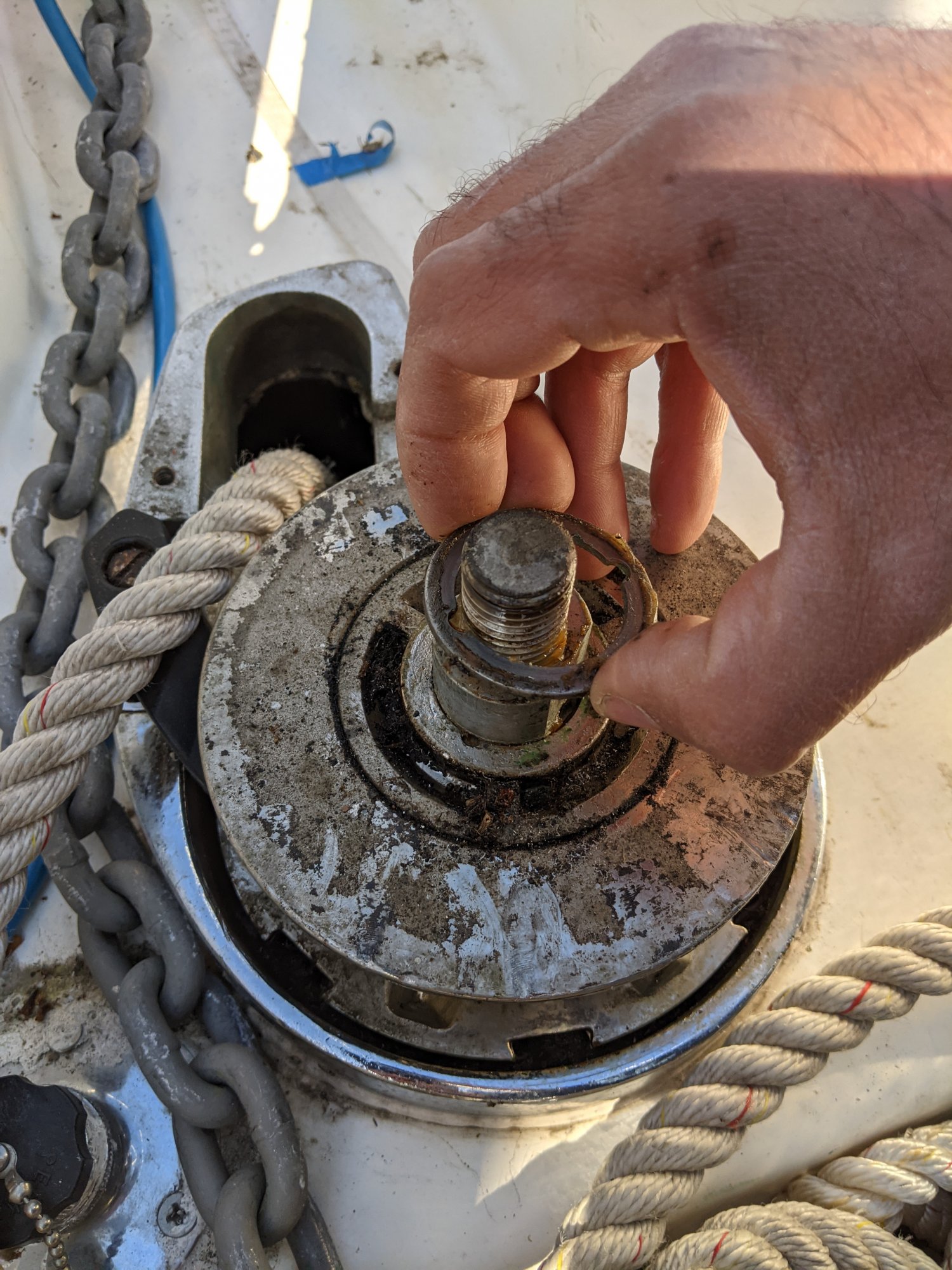

On my 376 the city water inlet is on the port side of the anchor locker, essentially the "opposite" side of the water fill port.
This was installed when we bought the boat. The previous owner used it regularly, apparently, but I have not personally used the connection.
Doug

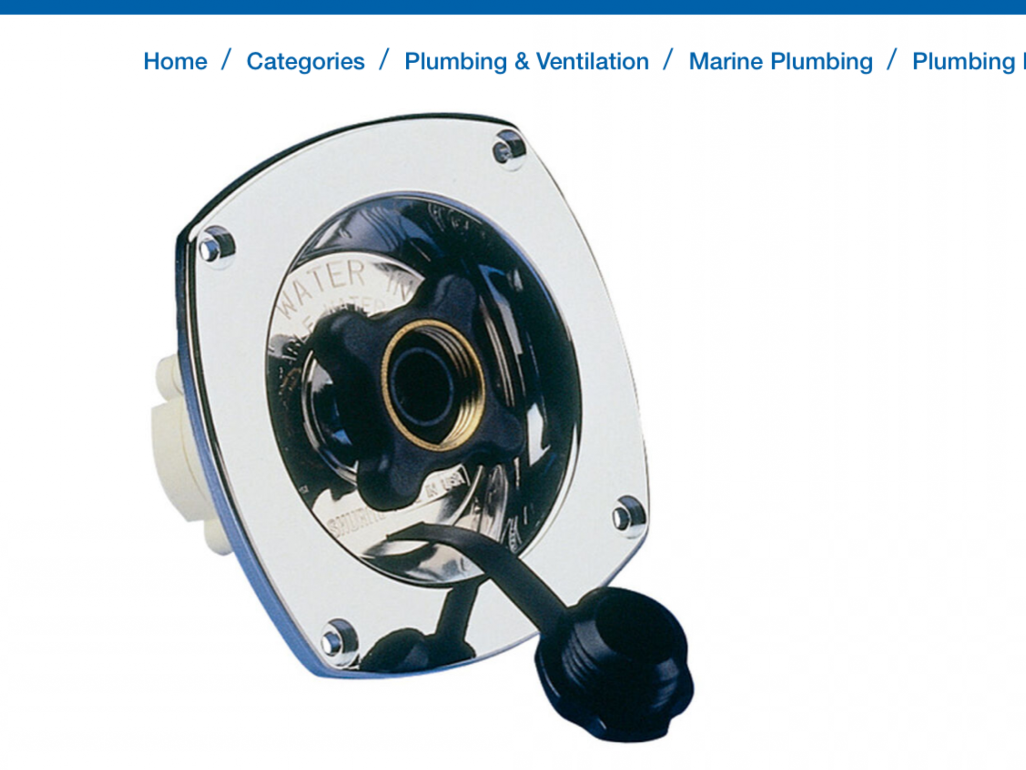

I think this combination regulator/one way valve is what you are looking for.
just about every boat in my marina uses it or something similar. 7A27B830-E9DC-4FE6-844E-889CC7D4C55E.png

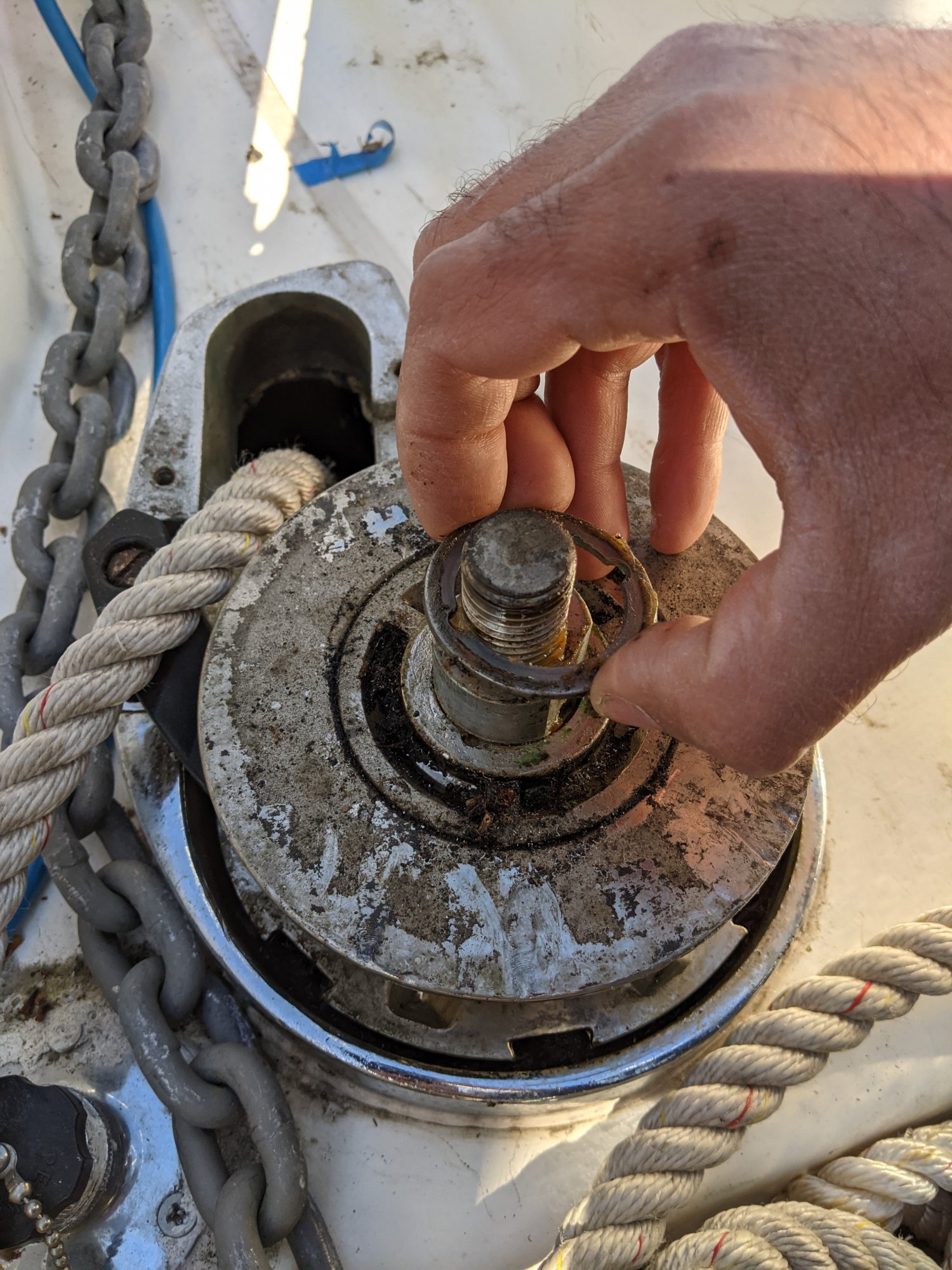

I was looking, but didn't have a super great direct shot of the water connection. The picture I did have is of my windlass (partially disassembled) with the water intake on the bottom left side of the image. Hopefully it gives some context as to where my input is located (as a side note, the PO did a terrible job of bedding the port...I recently rebedded it with butyl tape so it doesn't look quite so ugly).
