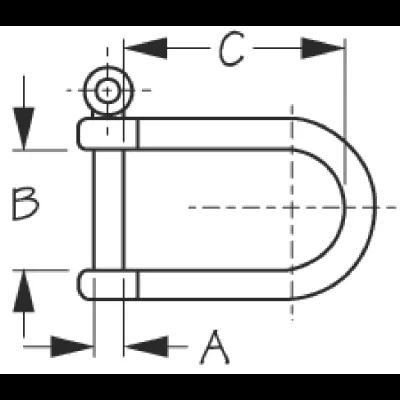

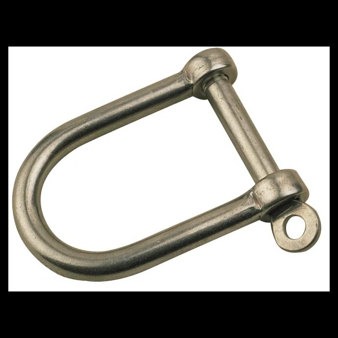

Ok Rob.. what about this one.
It is 1 1/8" wide at the "B" opening and 1/4" sized pin.
There are additional sizes up to 3/8" and 1 11/16" opening.
The wide shackle would concern me. Why finding a gooseneck with that wide of a solid tack seems odd to me.

While at the boat on the weekend, I dug deeper through stuff found the misplaced mainsail tack shackle. Just to close off the thread and for reference sake. The Goose neck fitting is just shy over 1-1/8”. The shackle width is 1-1/4” and the pin size is 1/4”

Specifications
MFG #:147186-1
| Pin Diameter1/4"
A
1⁄4"
C
1-11⁄16"
B
1-1⁄8"

Thanks. It wasn’t just any shackle that I chose. It was the original one that was misplaced. I like the idea of drilling a hole through the end of the screw as a safety. I’ll look at doing that next.
As an aside, I think the 1/4” wide d shackle you sourced, like the one from Fisheries, would be a challenge to use because the B dimension is narrower than the Gooseneck fitting. The Gooseneck would have to be filed down to take the 1-1/8” shackle width. Spreading the shackle would splay it and likely cause it the pin holes to misalign in such a way that it might no longer take the 1/4 screw… a pin might be forced through, but I doubt it. My toolkit now has a spare 5/16” extra wide d shackle with a 2-3/4” long ,1/4” diam screw and double nuts on the outer end to keep it all together.
