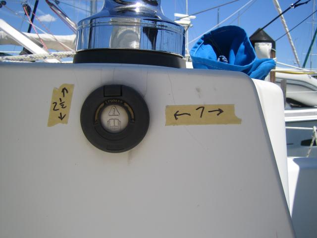

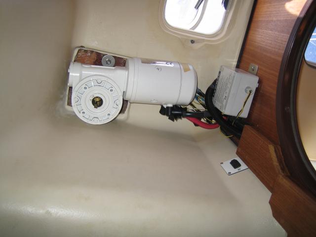

Attached are two pics of the installation I did. I had a Lewmar 44. The measurements are in inches and are from the fiberglas edge to the center of the switch. I ran the wires down the wall and into the engine compartment and under the engine (in loom) to the battery. The wires down the wall I covered with a teak board.
Allan

Alan, Mahalo Nui (thanks a lot) I appreciate the pics. I also ran the wire (2-0) under the engine and will probably do the balance similiar to yours. I ordered the extension kit from Lewmar because the fit was so tight I could not access the bolts for the motor/gearbox. Again Mahalo, if you are ever in Hawaii look me up and I will take you for a sail!
