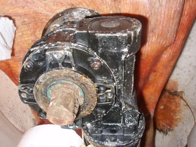

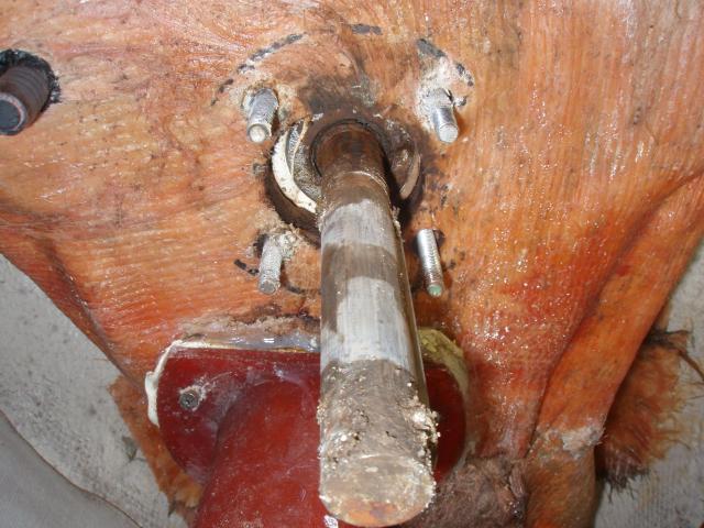

I am a new Hunter owner and have been struggling to remove the Anchorman windlass. It is not working but I can hear the relays activate when I press the deck mounted switches. I think the motor needs new brushes but I thought I would remove and rebuild the entire assembly as long as I was going to remove the motor. I can't seem to remove the gypsy and the clutch cone. I downloaded the manual for it from Pyacht.com. http://www.pyacht.com/sl-parts-anchorman-p.htm The exploded diagram reflects a part 59 set screw and part 72 friction cone that appears to thread into the top of the Mainshaft. After removing the drum, the carrier is exposed and I don't see the set screw that is reflected in the exploded diagram.
In all other respects my windlass appears to match the exploded diagram. Any suggestions for removing the gypsy/clutch cone?

Just for grins - and before you get too far along in trying to rebuild your windlass - make sure it's installed properly. Hunter installs these windlasses all day, so you'd think they did each one correctly. Not so. The Lewmar windlass are two halves - the outside drum/gypsy and the inside gear/motor. They're joined together with four stud bolts. Because the fiberglass is not even/vertical/smooth/etc. the two halves have a real tendancy not to come together in parallel. As a result either halve will bind the spindle. What Hunter does to fix all this is to add washer to the studs and shims the two pieces together. Sometimes it works, sometimes not. To evaluate your setup, Lewmar suggests removing the chain/rode completely from the gypsy. Remove the gypsy and attempt to rotate the spindel and determining if it spins freely or tends to bind. If it is stiff/binds/etc. the two halves need to be reshimed. It may take a few attempts, but refitting these halves together is much cheaper than replacing parts that are don't need replacing. Just MHO.

I just replaced the bearing on mine. For the second time, once in St. Lucia.. and now in New Bern, NC. The bearing part # is 6005 RS so I went to NAPA and they said #6005 2RSJ for about $36. It went on very easy.. My motor quit so I took it apart and out came about a 1/2 cup black powder from the bushes.. It has 4 bushes and they looked good to me so I put it back together. Tested it and it is working fine now.. Note: bushes are mounted on a circuit board and I would have to remove the back motor bearing to replace the bushes.
