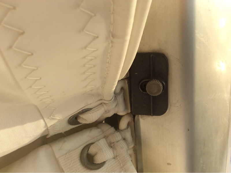

Pictures, finally
After three visits to the boat I finally remembered to take a picture of the mast gate. The gate is the correct one for the mast.
MDBack - thanks for the offer, but I have the correct Isomat gate. It's just not working with the slugs.
One picture shows the mast gate slid open, and all the slugs can get past it. (and slip out of the track, which they often do). The lower five slugs interfere with the gate.
The second picture shows the gate closed, and the slug bearing against it and unable to get past.
The PO used a thin piece of plastic for the gate, but we threw out before we realized what it was.
I think I'll keep the gate and shave off the starboard aft leg of the "H", the one hitting the gate, of the lower 5 slugs.
Any other thoughts?

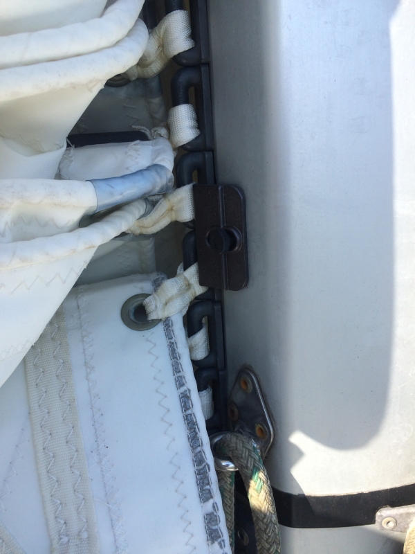

Here is my mast gate. Just like yours. As you can see, though, the sail slide is entirely in the groove. You can get different slides on your main, if that works for you.

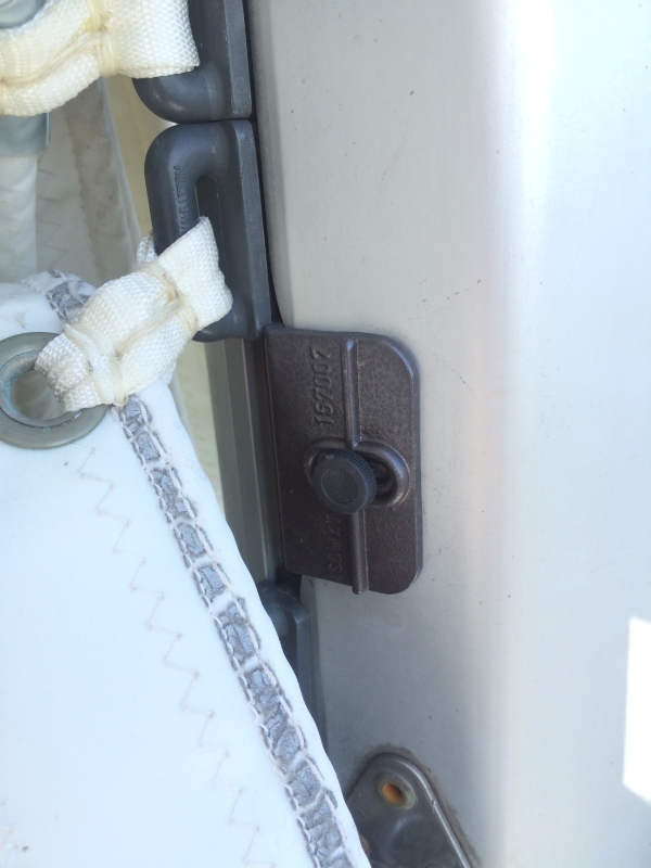

THere is my mast gate. I goofed up on the upload, sorry. It is Like yours. As you can see, though, the sail slide is entirely in the groove.

I have slides that are T shaped, not H. I have no problems with them. That second (aft) flange is your problem. I get the slides from Bainbridge.
